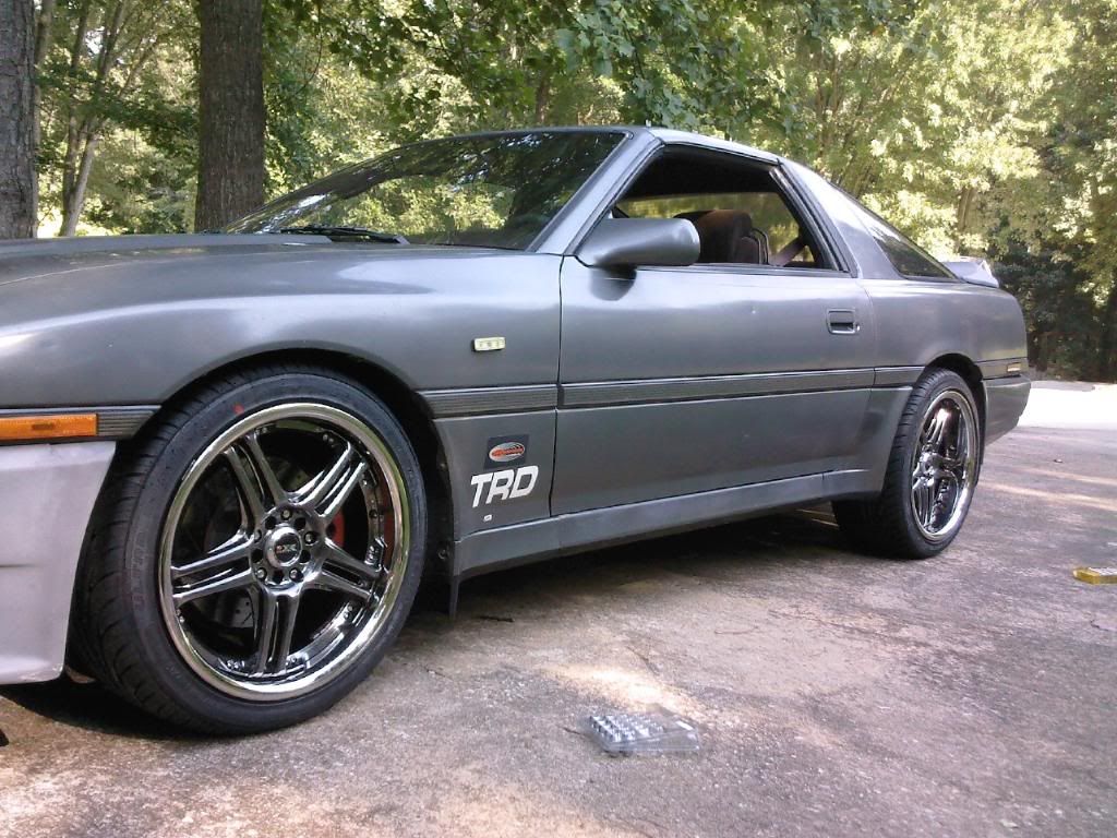

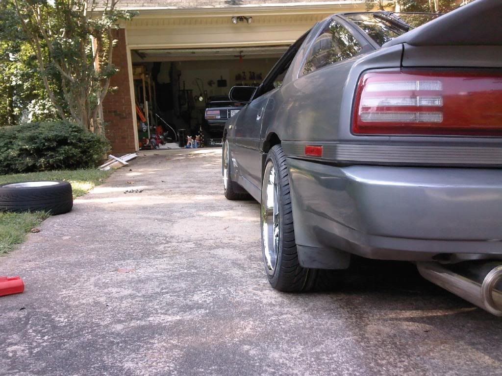

Hey! I finally get to add to the thread!
XXR (Sportmax) 502's in chromium back.
front- 18x8.5- offset 35, 235/40/18
rear- 18x9.5- offset 35, 265/35/18
