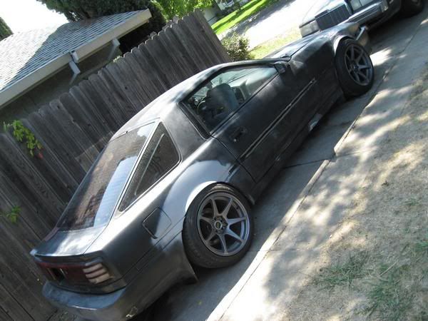

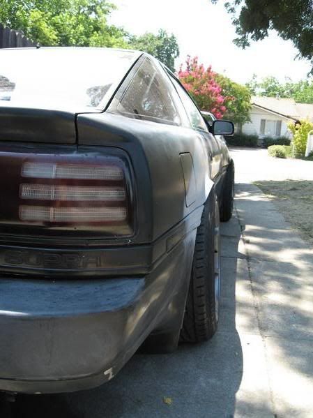

SHatty pics but you get the idea...
MB battles 17X9.5 +15 offset... 235 45 17 or maybe 235 40 17, i forgot!!!
Oh yea... 1.5" spacers on all four!!!
