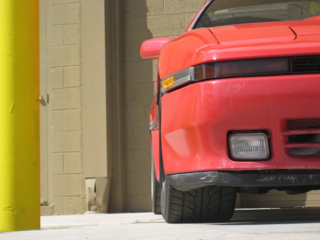

I wonder though, if I do space them out a bit, they'll probably stick out of the wheel well. Never much liked that look, and I think custom flares would be more trouble than it's worth. My whole desire for having the ability to turn more is to keep things in check if the ass end gets TOO far out on me, you know? I have Megan Racing coilovers, and when I raised the height up about .75" from where it was sitting, it seemed to free up more turning. Just don't like my Supra to look like a 4x4. :p
As for pictures, lemme see if I can dig one up... Here's about the best I can come up with:
spiller;1444658 said:
they are a +50 AFAIK. unfortunately with that much width and offset, there is no way around it but to use a spacer. 275 up front!!!
What can I say, I like to be able to turn and stop. My 2000 Miata pretty much ruined me, I gotta have lotsa traction anymore haha...

the way things look in those pics there...a 10mm bolt on space will probably be all you'll need to soprt things out on the inside, and you should still have plenty o room to play with on the outside...
