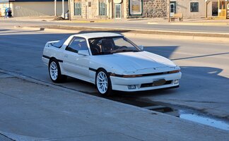

I realize the last post in here was from 2017 but I was wondering if anyone could tell me if I could get away with these without rolling any fenders.
I plan on putting springs or coilovers on the car at some point. Was thinking of doing these wheels on all 4 corners with 255 tires. Could I go any wider and still be fine without rubbing? I realize it's a tough question to answer but maybe someone here has these. Apologize if I'm breaking any rules. Thanks.
Jsway9
Mar 13, 2022
34
I have these on my car. Same measurements. No fitment issues

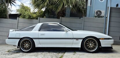

ironsights85
Oct 18, 2022
Still needs to get lowered(along with a ton of other cosmetic work)
18×9.5 38 offset plus 5mm spacers
245/40r18 front
275/40r18 rear
Minimal rubbing on inner fender when turning full lock, can't even hear it, not doing any damage, the spacers are so it clears the swaybar, wouldn't need them for anything else
Edit: lowered it, now it rubs the front fender lip slightly while turning under flex, but not on flat ground.

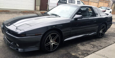

Have any input on this setup? Will I need to roll anything on my imported 1989 Supra? Would you change the offset any? The car was lowered but not too much (Not sure exactly how much my previous owner). Thanks for any info!
Wheel sizes
18x8.5 +35mm Front
18x9.5 +38mm Rear
Tire sizes
245/40R18 Front
275/35R18 Rear
57Bonus
Dec 14, 2022
19
10
69
Front wheels should fit without fender rolling.
Although can't say for sure about the rear wheels. For reference, I'm running 275/35R18 in the rear but on 18x10+35 and had to roll my fenders for clearance.

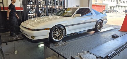

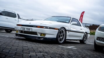

Howsit guys.
Had these Racing Sparco Viper by Taneisha on the car before 17 x 7.5 ET35(F) and 17 x 8.5 ET30 (R), had 225/45/17's right around and they were perfect.
Bought a set of Work Seekers about a year ago, had them refurbed and fitted them on Saturday.
But now with the Work Seekers 18 x 8.5 ET28 (F) and 18 x 9.5 ET16(R) I wanted 235/40/18's but no1 seemed to have stock of a decent tyre.
Managed to find a 225/45/18 Bridgestone, which looked perfect and drove very nice. Until I got home and had to full lock the steering to turn into my steep driveway and heard some rubbing. Right side rubs when full lock to the left and Left side Rubs when I full lock to the right. I'm very keen on keeping the Fender liner Stock and definitely do not want remove it. will either go for a 225/40/18 up front or will some negative camber help? I'm worried negative camber may make the inside wall of the tyre rub.

Howsit guys.
View attachment 89312View attachment 89311
I’ve used this calculator many times to get measurements on wheels and tires to match the circumference of the stock sizing to keep the Speedo the same.
I removed my fender liners, tucked the wiring harness up and hammered in the metal that would potentially cut your tire. 275/35-18x9.5+22 is a nice, predictable setup on these cars.
