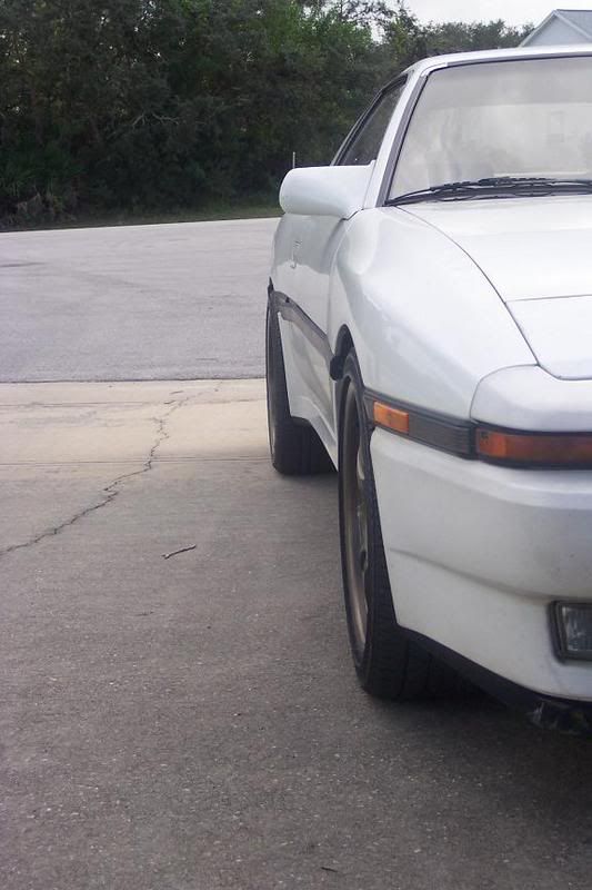

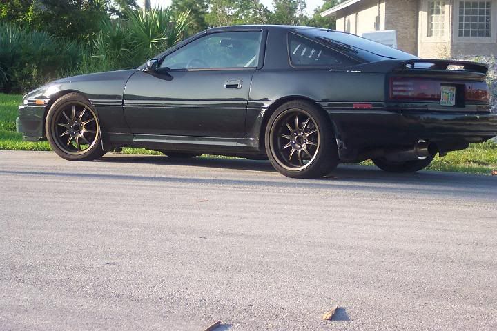

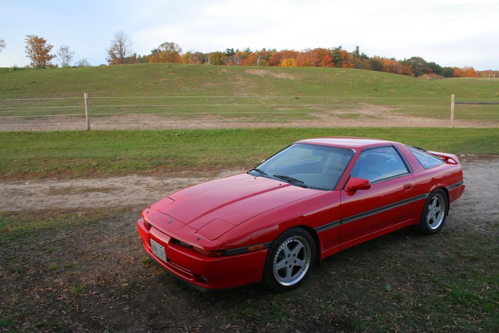

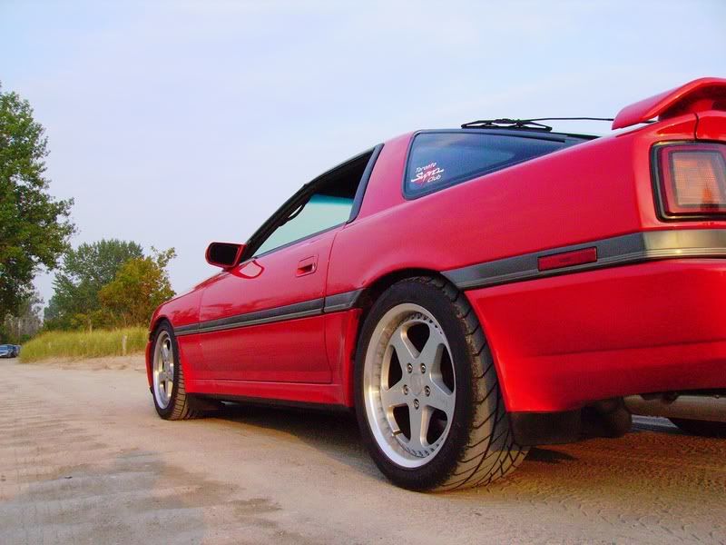

Wiisass
18x9.5+12 front, 18x10+18 rear
235/40/18 front and rear
Work XT-7 in the front, XD-9 in the back.
I thought I had pics with the XT-7's on all around which is how it usually is, but I can't seem to find any and don't want to look anymore. But the 18x10+18 has the same outer fitment as an 18x9.5+12 so they both sit as flush.
Edit: Nevermind, found a side shot with xt-7's all around.
Wiisass
Thanks, I was surprised at how well they fit. I had bought the wheels to use on my S13, but they look better on the supra. We did have to roll the fenders, but that's something you're going to have to do if you want good fitting wheels anyway.

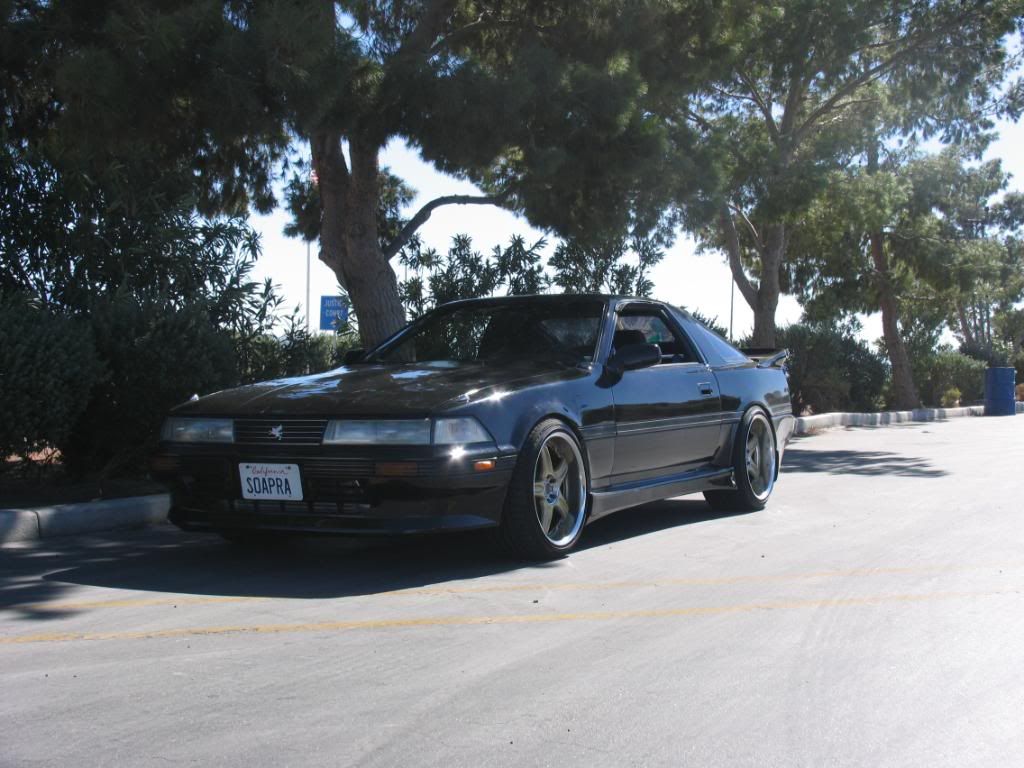

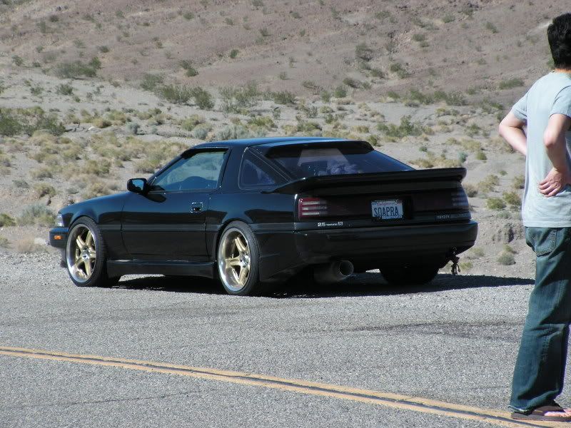

A-to-the-J
Panda™ and Pre-89 Gracer™
Feb 19, 2006
1,080
Anaheim/West Covina, CA
IMHO, Jose has one of the best wheel fitment to date. the new wheels he has are awesome and the pictures posted just don't do it justice.
EDIT: i stole a couple of joe's silv pics.

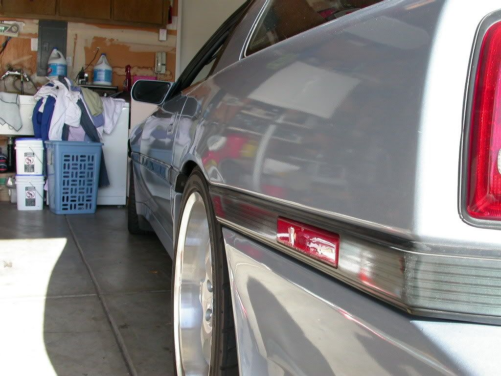

tissimo
Stock is boring :(
4,238
Melbourne, FL
my old setup 18x8+32 18x10+35 245/40 275/35
hks coilovers. minor rub on hard compression
on my car..
showing fitment on my old 87.. eibachs no rubbing
Wiisass
bowsercake said:
Is 235 the most you can fit in the rear without issues or was it the first tire you tried? Looks good for drift I suppose.
235 was what I had. I've used it for drifing and for road racing. I had the car out at pocono with the 18x9+20, 18x10+18 setup on there with 225s in the front, 235s in the back. And the tires weren't what was holding the car back. But you could go a little wider in the back, a 245 should fit, a 255 would probably rub. But I also didn't pull the fenders at all.

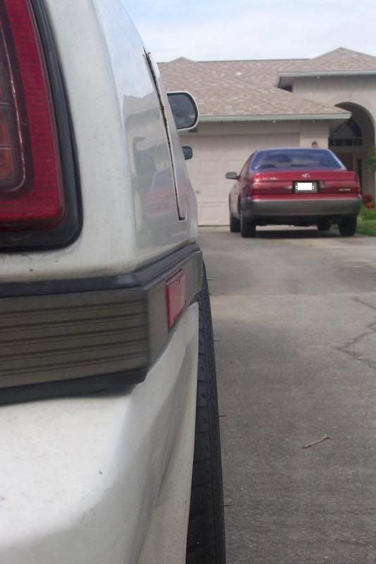

werewolves182
is without a supra :(
Aug 23, 2005
436
Crownsville, MD
BorHor said:
I have been seeing alot of wheel fitment threads on here recentley. So I hope this will clean it up a bit. Ask what you want about a wheels fitment and I will try and answer or actually anyone can help. Just remember 18" is not enough info. We need Diamter, Width, and Offset. With out those 3 there will be no answer.
My current set up is 18x8.5 and 18x9.5 with 35 offset all around. It is decently flush but if the front were like 25 I would be more happy. You can use those for a guideline. I am running -1.5 camber in the front and around -2 in the rear
http://i172.photobucket.com/albums/w32/BorHor/Dyno 9-16-07/mini-IMG_3493.jpg
http://i172.photobucket.com/albums/w32/BorHor/10-5-07 Exhaust/DSCN5082.jpg
Ask away. :icon_bigg
BorHor, What size are your tires? Reason being is I have the exact same size wheels and offsets you but im having issues with rubbing and sidewall height front vs. Rear.
Thanks

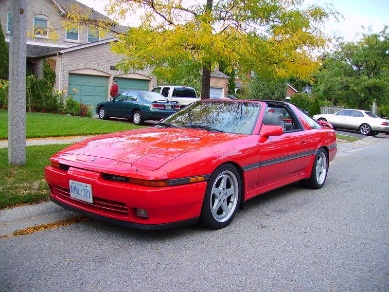

Sawbladz
Mar 14, 2006
1,727
Oshawa, ON, CA

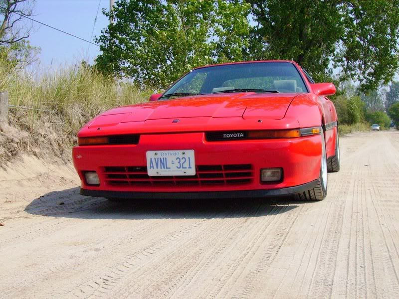

17x8 Front +25, 225/45/17
17x9 Rear +39, 255/40/17
I personally feel these wheels fit perfect. They are FLUSH in the front. With the 225 I have had them rub only once. I beleive with a slight roll I could fit 235's for sure, possibly 245's but I will do some measurements before confirming. The rear's are almost as flush and allow plenty of fender clearance to fit any size tire. I will be looking at inner clearance but see no problems running 275's. I woud also like to stress that my tires have no stretch. They are very square shouldered and the 255 BFG's tend to run wider than the same size in other brands.
EDIT: Car now has 275's in the rear and the fit is still great.
