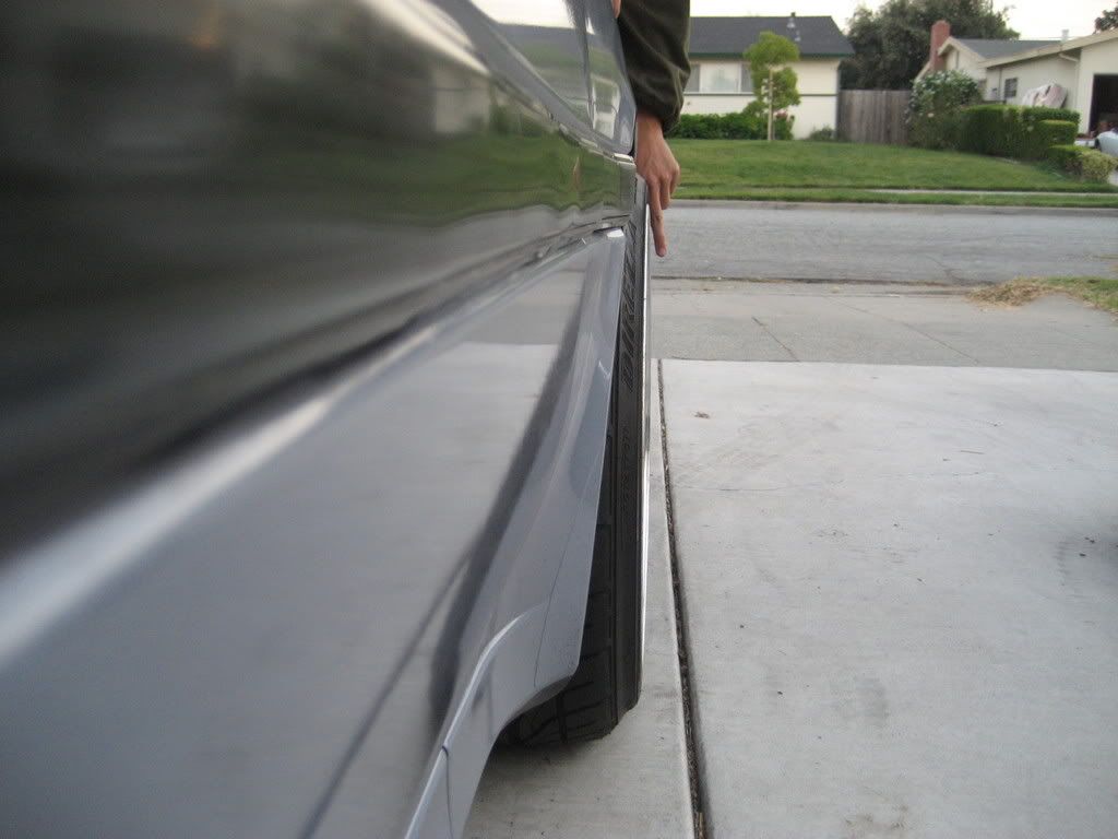

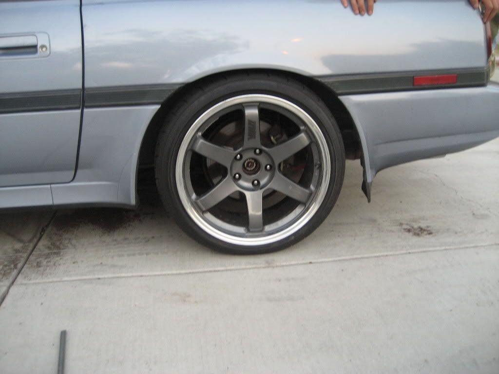

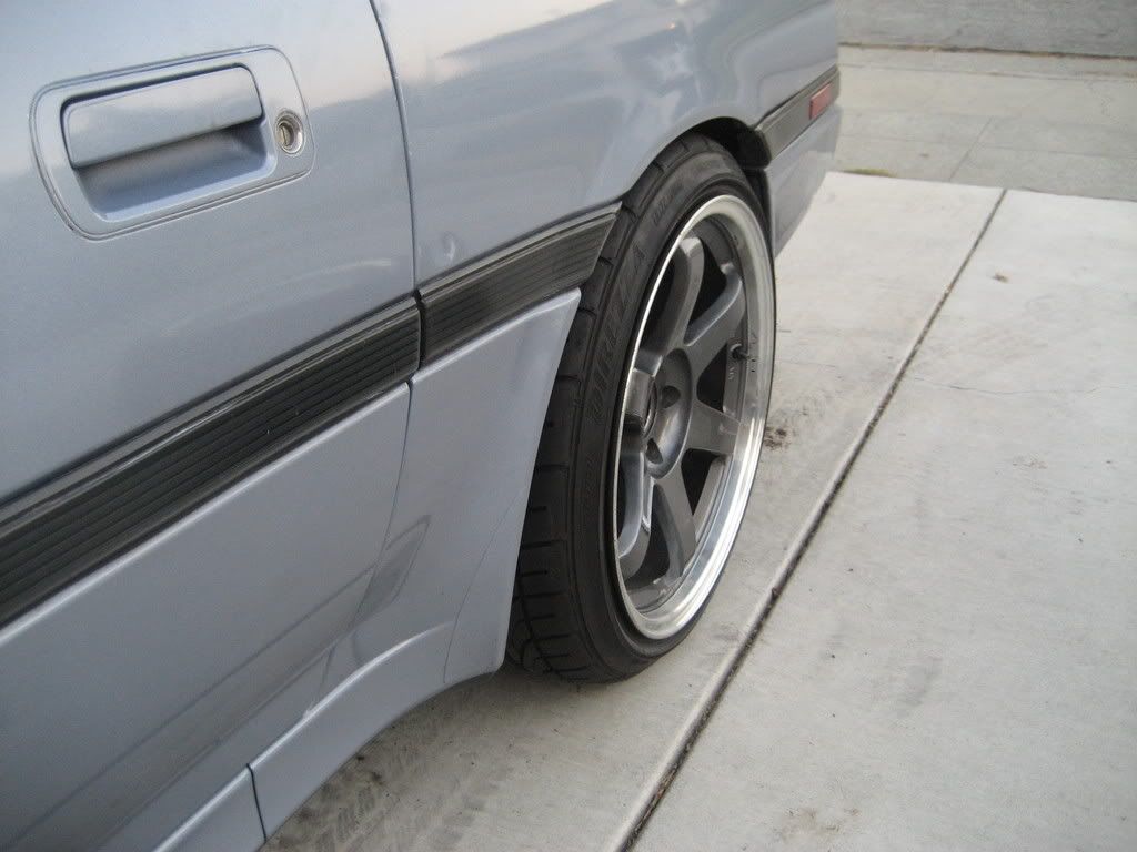

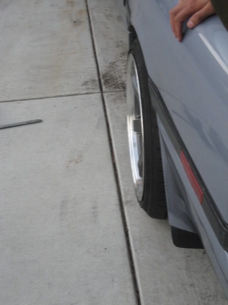

That was a 18x9.5 +12 as stated already. This is just a test so I know what I can fit in the rear. Now something more extreme is coming up ;)

Probably going to use 225 in front and 245 or 235 in the rear. how low do you think I can go on the 10's?
On the first page, the pictures I posted were with a 10+18 with a 235/40. I think we could still go a little lower with the car in the rear, but without lowering the front anymore, it's not really worth it.
