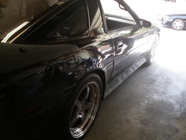

Wheels unknown.....
17x8 fronts and 17x9 rear.
Offset unknown either
Tires are 225/45 fronts and 235/50 rear
Car looks a bit high because the wheels are only on side and the stock sawblades are on the other at the time taken. Car hasnt moved in months so its a bit dirty. I brought these wheels knowing nothing about them nor if they fit but DAAMMM I was lucky. They fit nicely with plenty of gap in the back.
