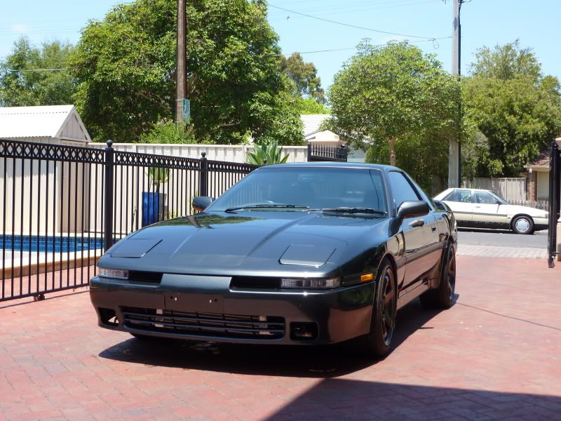

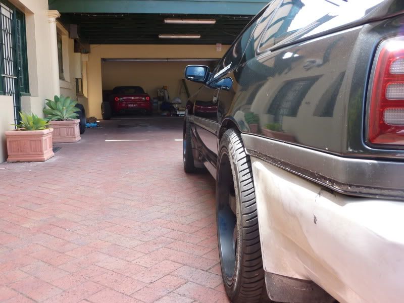

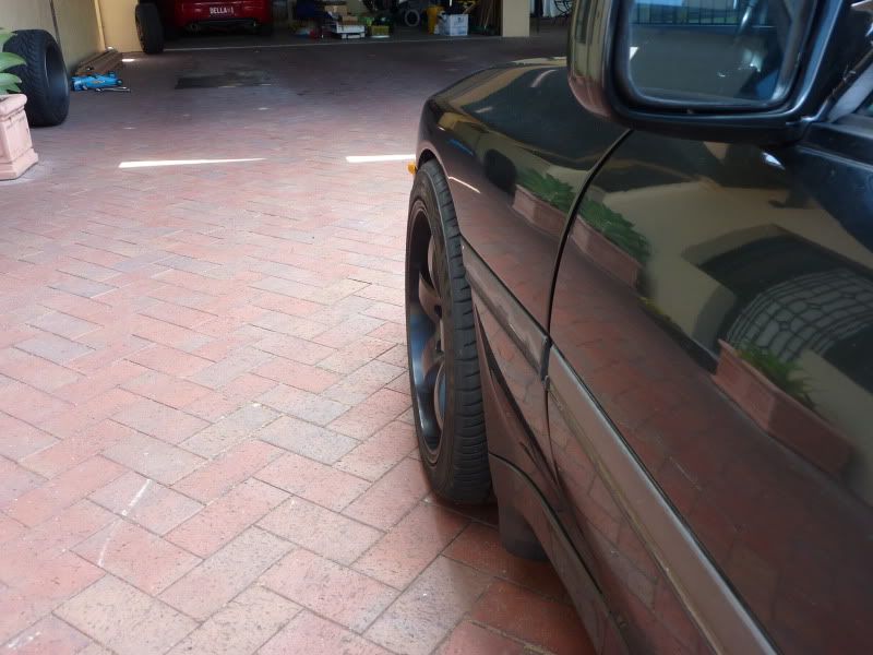

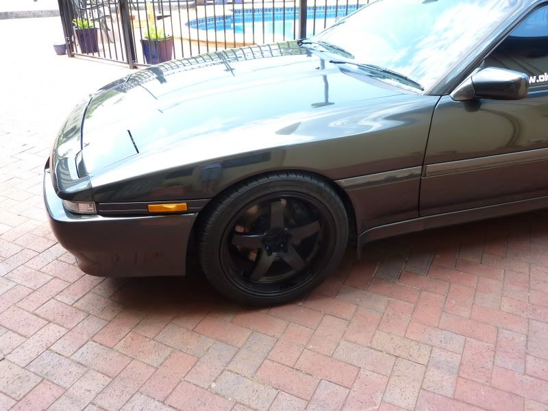

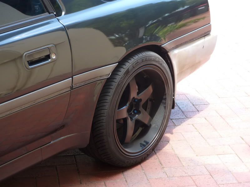

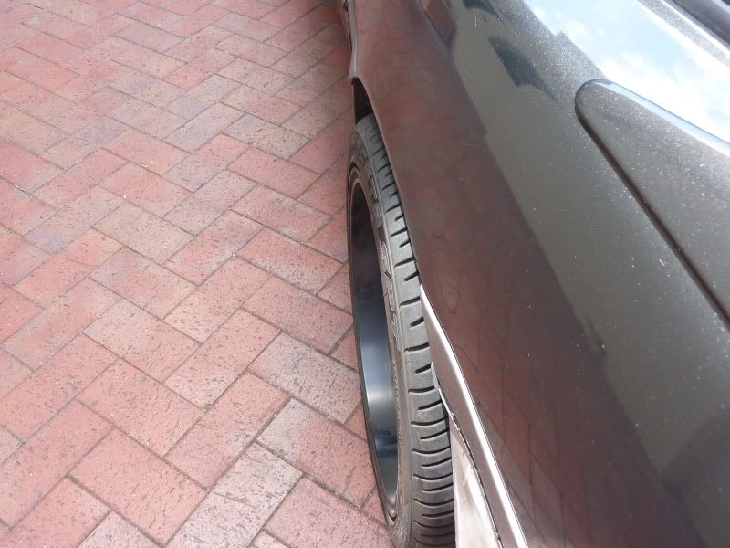

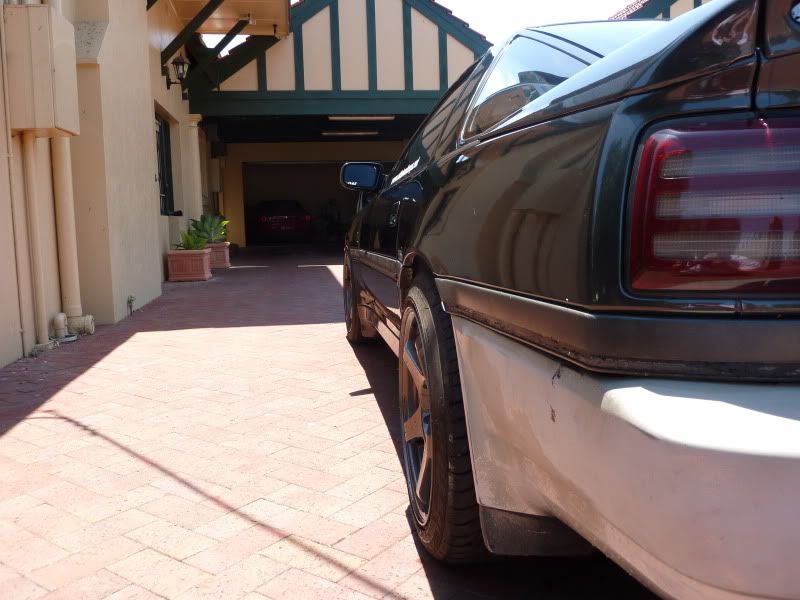

got some pics and specs to add.
1) Koya Drift-teck
17x9 +30 front (235/45)
17x9.5 +18 rear (235/45)
2) Lenso D1R
18x9 +15 front (245/45)
18x10 +18 rear (275/35)
^^an inch of lowering + camber that comes with it will be perfect!

Spiller;
The Lenso's look great! I would have gone w/ a 255/40,(on the 10's) or 35 and dump it low for the "tuck" (lol!) I am starting to like the very aggressive offset look more so,:love: than the 'old school' fat tire appearance. I have recently adopted the same look, but cannot get my car as low as I'd like, unless I install different adjustable coil-overs.

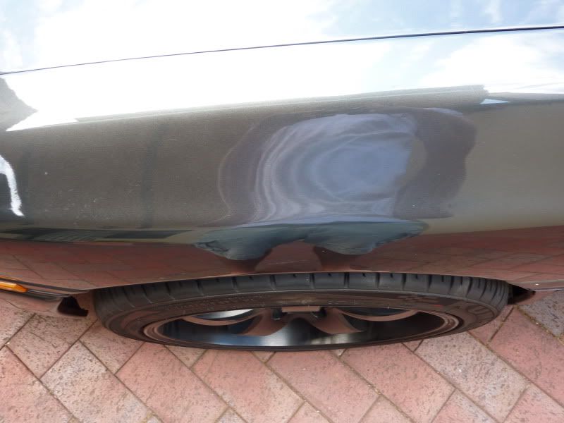

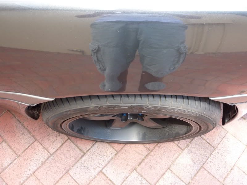

spiller
Mar 5, 2008
582
Australia/Chicago
Thanks for the kind words! Stretching the tyres would be much easier but I like as much tyre on there as possible - they aren't over-tyred as such, it's pretty well spot on but I think once I lower the front more I will destroy the guards whether they are rolled or not. So, I might get 5mm or so machined off the centre of the fronts so they tuck easier...
