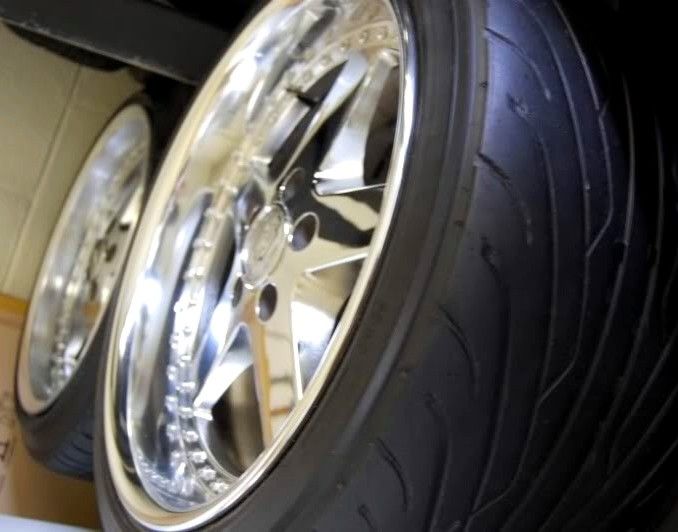

Threw some tein hr's on there and tested some wheels.

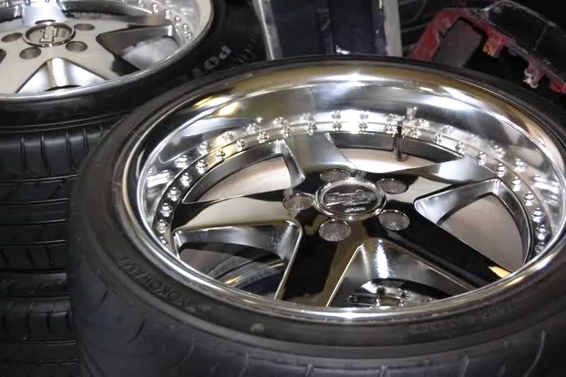

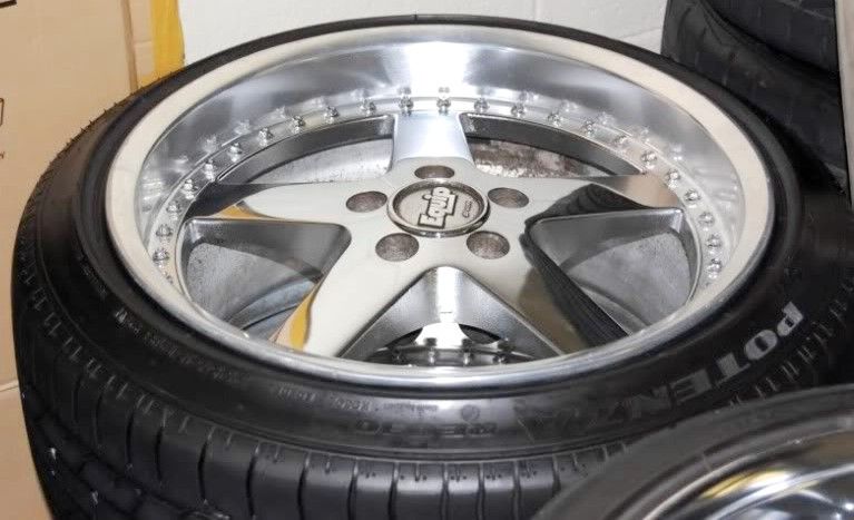

18x9.5 +24 offset, 18x10 +18 offset 5x114.3 bolt pattern
^^^ What would happen with some WORK EQUIPS of that size?:aigo:
Would these be "workable" with my Supra???
(Don't really need rims that are THIS DEEP but they are gorgeous!:biglaugh:)
^^^ What are these worth if they fit?

Those will work, with a stretched tire, and rolled fenders. As for cost, they aren't cheap!!! I've seen similar examples for as much as $1800-$2000! One more thing to consider. If you were planning on big brakes(?) I'm betting that those low disc fronts, won't clear 4-pot calipers w/o a spacer. Those are a discontinued model wheel, and should draw a premium price.

Thank you for the input! I thought as much, and wish to be a bit more "conservative" with the setup, even though I'd still LOVE to have this model and style!
Maybe I'll find some with closer sizing for a more readily mountable fit.
