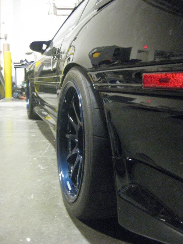

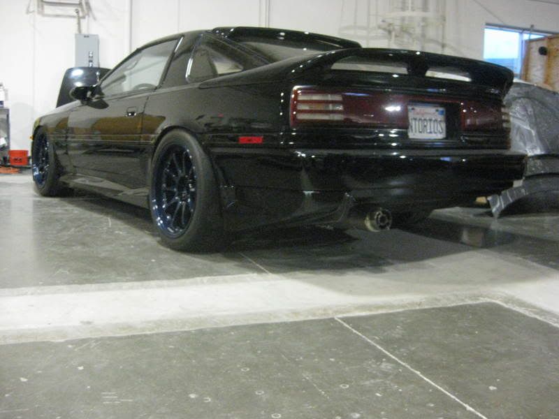

For reference, this is an 18x10.5+22 w/275/35/18. The fender is rolled and flared out. 295s could be mounted, but the car would have to be raised significantly, so that the tire does not hit the fender when the suspension compresses; otherwise, if I wanted to keep the ride height the same with 295s, the 10.5" wheel would need an offset in the high 40s

315s on an 11" wheel? If I answered, I'd be wandering into unchartered territory. At least unchartered by me. FYI, a 315 tire is actually wider than an 11" wheel (which is about 305mm wide). My suggestion is either buy or borrow a 17x11+35 wheel. After you mount it, then you'll be able to calculate what tire will fit the car.
Check this MKIV out. It has 18x12s w/295 tires at the rear

My rears, in my sig picture, are 10.5+18 ( w/245/35/19s), coupled with 15mm spacers is equivalent to an 11"+9.
Yes, the tires on the Mag Blue CE28 are NT 01.
