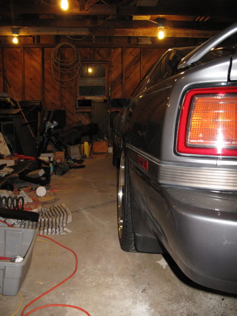

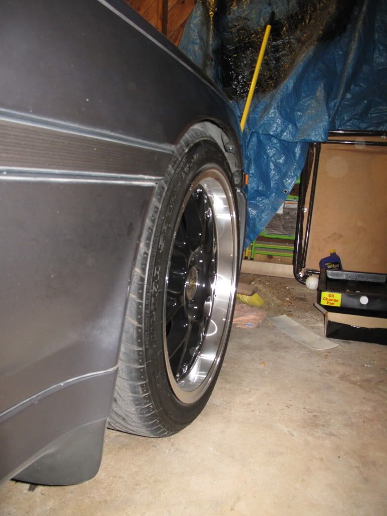

after posting on this thread that i wanted to with 19" wheels all around. I did decide to go with 18".
18"x 9" (+38) 255/35 in front
18"x 10" (+35) 265/35 in the rear
"zdaeng" posted a picture. Personally i like this look better than 19".
My questions are :
Do I need spacers and /or would i still have to pull the fenders in the front or rear with this setup?
The reason I am asking is cause I can tell if he pulled them (i doesn't look like it)
*My wheels are built to specification by a company out in Florida $1200-1700 each they 3-piece
*A Little Off Topic* (I also posted this portion in the brake upgrade thread)
will the K-Sport Big Brake Kit fit underneath 18" x 9" (+38) in front &
18" x 10" (+35) in the rear or will I have a clearance issue.

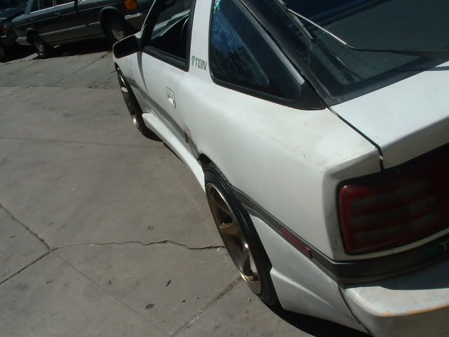

R3N5LOW;1383356 said:
Alright.
so i was wondering if there were anymore pictures of this set up/car
10" +12
and size of the tires?
http://i51.photobucket.com/albums/f360/R3N5LOW/DSCF0193.jpg[IMG]
[IMG]http://i51.photobucket.com/albums/f360/R3N5LOW/DSCF0194.jpg[IMG][/QUOTE]
I dont know about that car but here are 17"x10 +12 with 255/40 on the rear. Lowered on Eibach Pro's, no fender rolling, no rubbing, small negative camber.

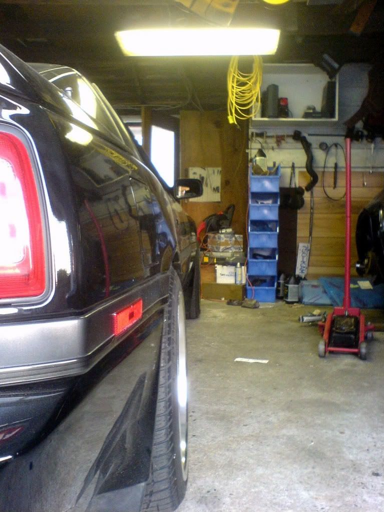

JB91389
decisions...decisions...
Jun 22, 2006
698
Ottawa
Looking for an aggressive stance, but these are the only sizes availiable. nothing really low offset, but perfectly flush is fine by me too
What would be best for the fronts?
18 x 8 offset +35
18 x 8 offset +25
18 x 8.5 offset +35
Recomended tire size?
What would be best for the rears?
18 x 9 offset +35
18 x 9 offset +30
Thanks
18 x 8 offset +35
18 x 8 offset +25
18 x 8.5 offset +35
18 x 9 offset +35
18 x 9 offset +30
Thanks
18 x 8.5 offset +35 with a 245 or 255/40 tire
18 x 9 offset +30 with 275/35
