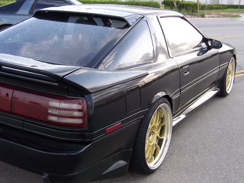

Thought i would add mine to this since i have a new set on these days.

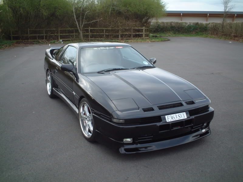

Fitment is 19/8.5 on the front with a +30 offset. Tyres are 235/35/19.
Rear is 19/10 with +35 offset. Tyres are 275/30/19.
Had some minor rubbing with this set up but did a small amount of arch work on the rears to cure it.

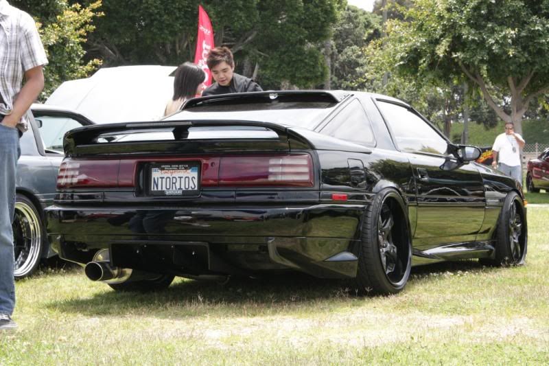

I've tried reading through most of the thread, and saw that Borhor has 17x10's in the rear. Would it be possible to fit a wider tire on the rim so it wouldn't have the 'stretched look'? Secondly, Borhor have you just rolled your fenders or rolled and pulled?

You just have to consider a few factors
1. Fender modification
2. Wheel offset and width
3. Ride Height
4. Suspension camber
For example, talking about rear wheels...if you want to be able to fit 295s on a 10" wheel
1. Roll the fenders
2. Offsets in the high 30s and low 40s
3. You could have a relatively low ride height
4. You don' t need any negative camber.

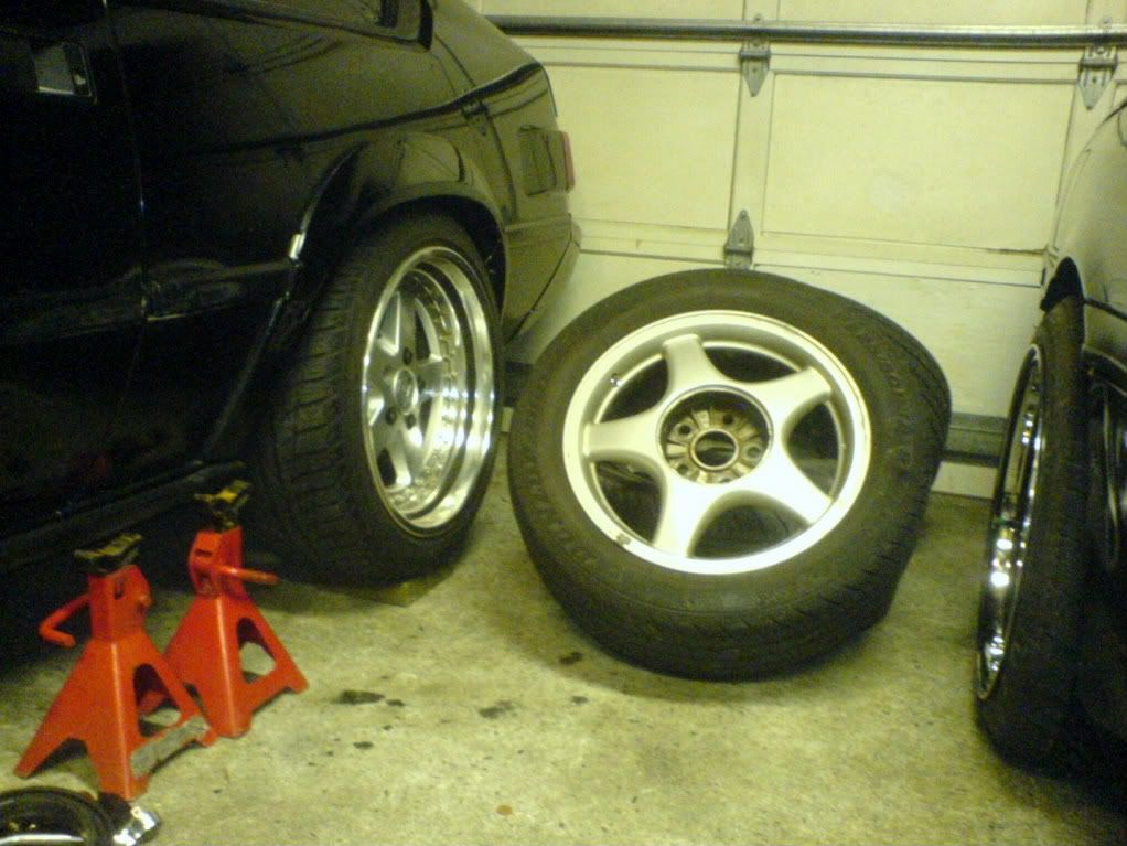

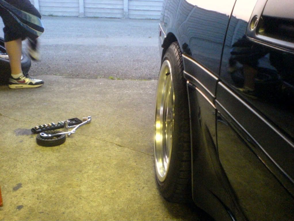

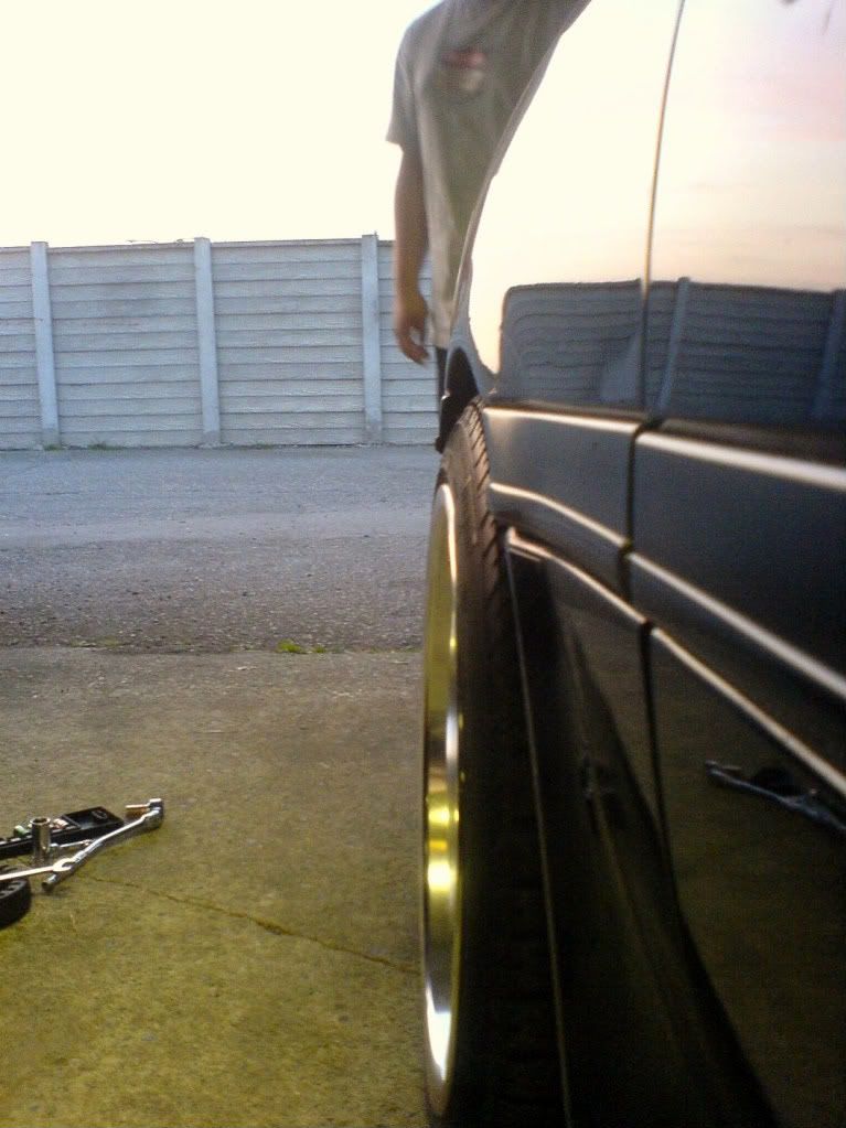

BTW, Bor...I was just joking around with my questions on the 11.5s...I actually gave some thought on the fitment prior to posting. Since I rolled and flared my fenders, 10.5+18 wheels (w/265 tires) are sunk inside the fender.
I dropped the car more. Also I wanted the wheel to poke out...so I added 15mm spacers, to a different set of rims with the same 10.5+18 offset, pictured below.
I want the same look above without using spacers. So I could go either 10.5+3 or 11.5+16. Since I want to try a wider rim, I'll be going 11.5+16s w/ 265 tires (but first I have to see if there is enough inside clearance.)
