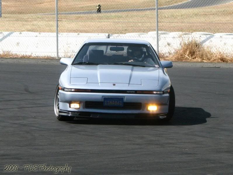

I drifted with 18x9.5 +15 18x10.5 +15 but I am a litte nuts haha. I was sliding with 100 hp/tq too ;)
I wish I had more pics of that set up sliding :(

Was that on your coilover setup? Those pics put you in the tiny niche of no body roll. lol almost unheard of in the community still.
With all the negative camber did you notice any effects on the drifting on the car, either good or bad? Maybe good cause it gave you more tire contact and more smoke?

I had stance at the time. As for all that camber drifting, I bet it had a larger contact patch but it was the only way those wheels would fit lol.
