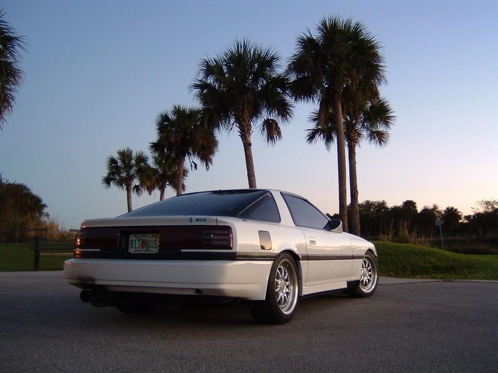

Type-01? They would look like this.
FYI they are probably 2PC, Blitz welds the barrel halves together.
