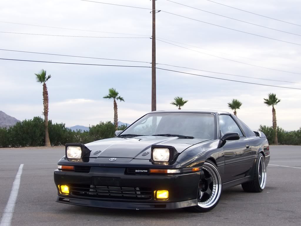

I still think a pull would be needed.. that would be sitting a full inch outside the fender on my car, and it's dropped decently.
this picture make me doubt that somewhat, but the rear fender was pulled in this pic IIRC:

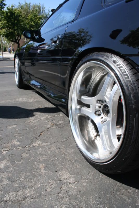

If you have a +40mm offset and add 25mm spacers. what does that put your offset at.
I have 18x9.5's with a +40mm offset. Sunk in like a tweens chest. I got 25mm spacers from H&R
fronts are 245/45/18 rears are 275/35/18 i am going to get new rears. I was thinking 255/45/18 <---bad Idea?? maybe 245 ?
This is from the rear looking towards the front. 18x9.5 245/45's 40mm offset with a 25mm spacer

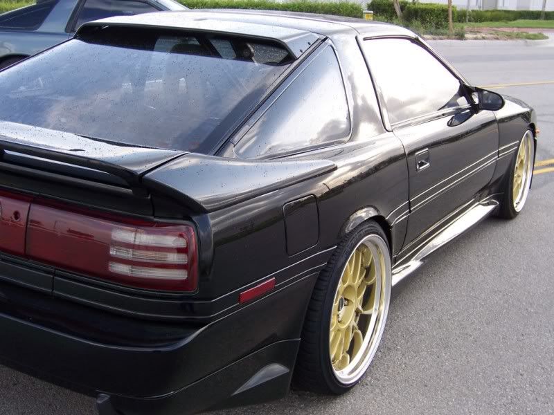

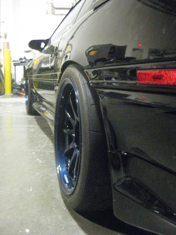

This is front looking towards rear. 275/35/18 with a 25mm spacer as well
