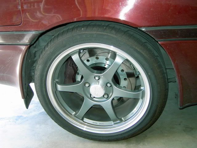

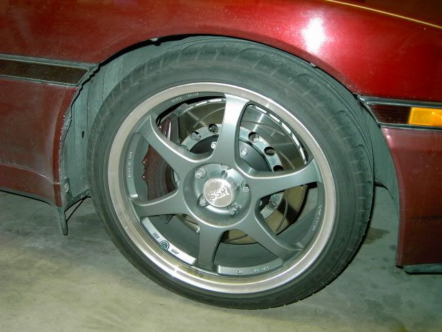

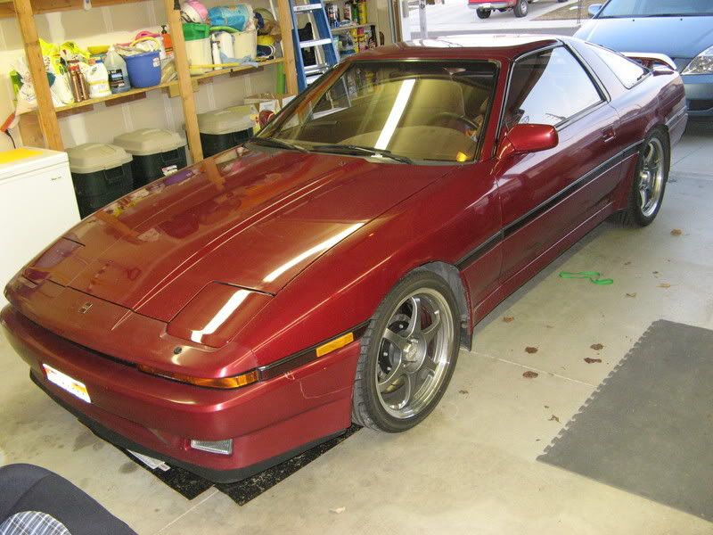

To simplify your search, any fitment that is for the MK4, will work on the MK3 in my experience.
I had SSR Comp's 18" staggered on my MK3, and it was excellent, and cleared massive brakes no problem. (They are not as much as the Ray's, but I'm not sure they are in production anymore.)

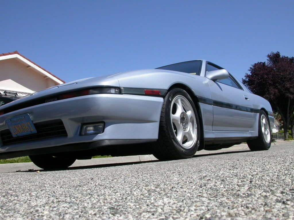

I just recently got mkiv tt rims, and i was wondering what size spacers would give me a nice fit. I saw Bohor's car with mkiv NA rims and spacers and i really like how it looks, would getting the same offsets work for the TT's?
---------- Post added at 08:36 PM ---------- Previous post was at 08:35 PM ----------
BorHor;807572 said:
MK4 NA's with spacers
16x8 +22
16x9 +35
EDIT: The spacers im looking to buy are:
10 x Preinstalled Studs
10 x Chrome Lug Nuts
5x4.5" (5x114.3mm) bolt pattern to 5x4.5" (5x114.3mm) bolt pattern
The only thing is they are meant for mustangs 94-11', will there be a problem as the hub bore for the mustang is 70.5mm while the supra has a bore of 60.1mm?
