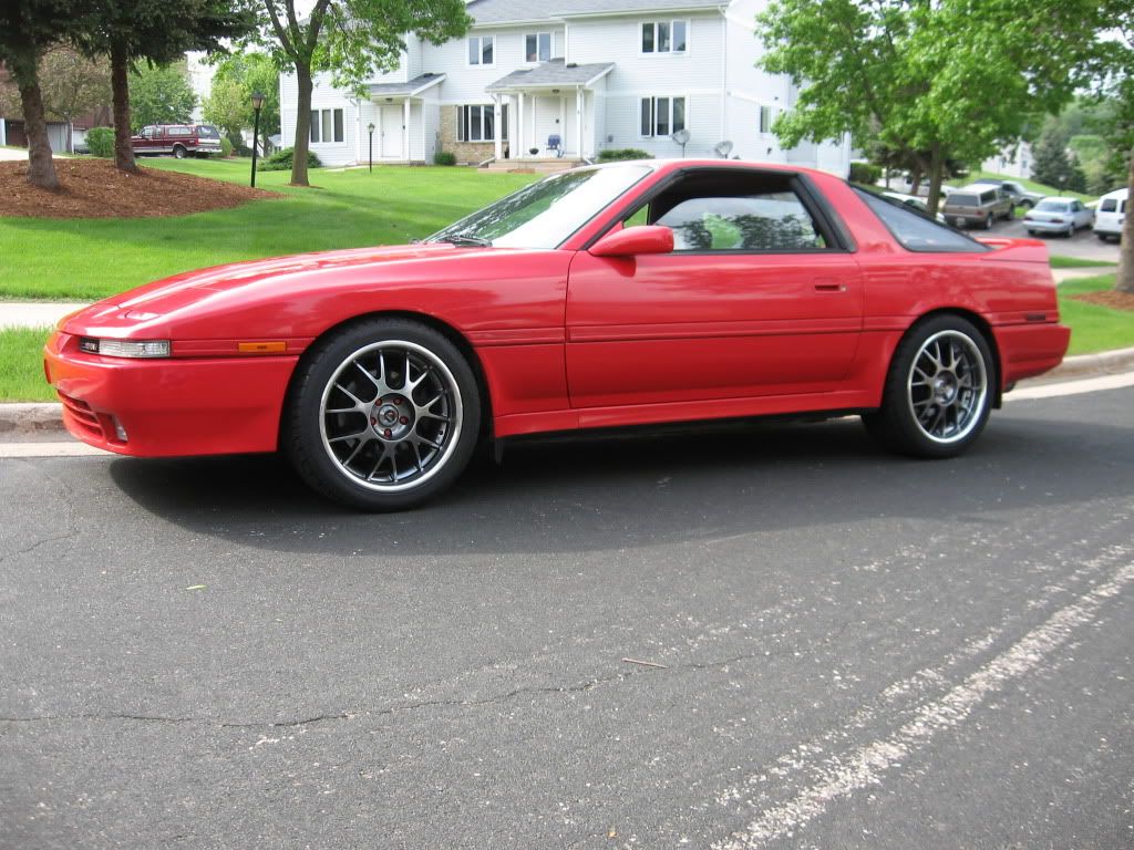

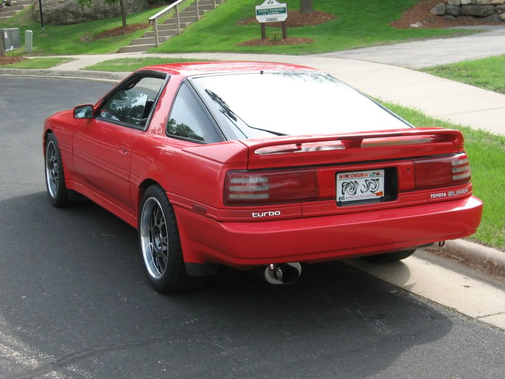

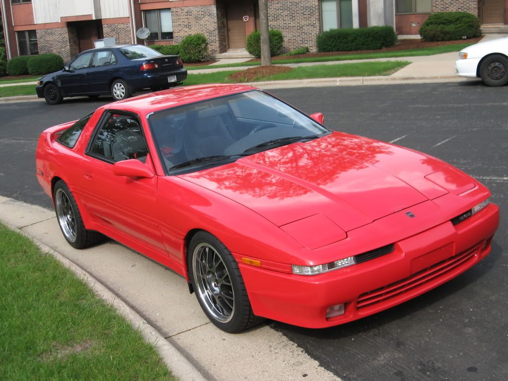

Specs: Stern ST-7
18x8.5+32 245/40/18
18x9.5+35 275/35/18
Eibach springs, Tokico Illumina II's
