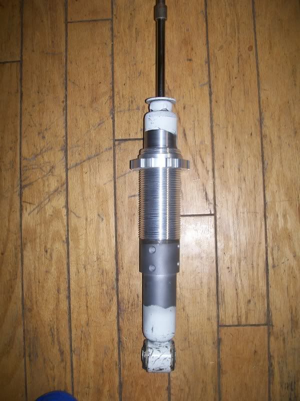

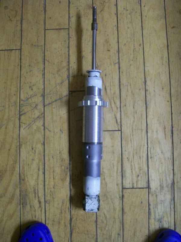

I'llet let the pictures speak for them selves first ;)
the tube was sweated on first then very very very carefully spot welded in place.

Cool. How do ensure that you don't blow through with your spot welds? I tried something similar once. Gave up after destroying several shocks and lotsa $$$.

Very very interesting, but do you think those spot welds will be strong enough taking into account how thin the metal on the shock is?
I'm sure it's fine. Strut perches are built similarly.

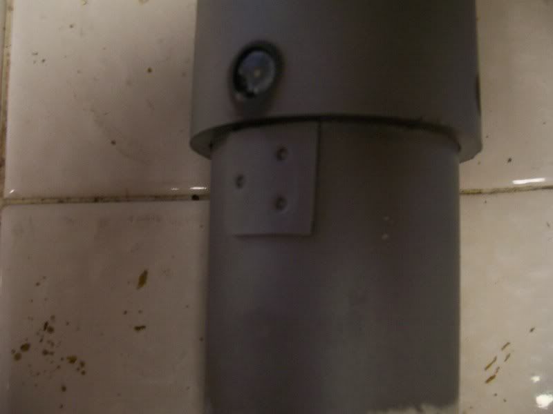

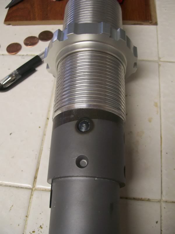

The trick here is keeping heat dissapation in mind in order to make a strong secure weld without overheating or distorting the shock/strut. So I used a piece of tube withe the greatest amout of mass to absorb the heat from this spot type weld. I also used a chamfered hole so that there was good bonding between the tube and the shock at the beginning of the weld, and then dissapate into the sleeve.

They're QA1 sleeves, and I plan on using the stock springs to start with. I'm still working on the perches. I'll post more pics as I go.
exactly. those spot welds have lots of strength, plus it's sweated on. It's not going annywhere.

Personally I'd have extended the tubes almost to the base and do the rosette welds down there away from the pistons working surface in the bores.(assuming single tube shocks)
