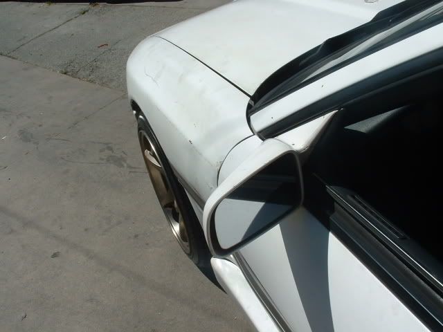

garagefujimoto said:
Lighting is still bum, plus unfinished sanding fail
Crappy angle too
So are you saying that the suspension will actually travel and it won't rub. So if you were to drift the car, the tire wouldn't get eaten up by the fender? I really don't see that happening unless you're running way too stiff of a suspension. If you take some more pictures, take some down the side of the car or from facing the wheel and standing above it and looking down on it.

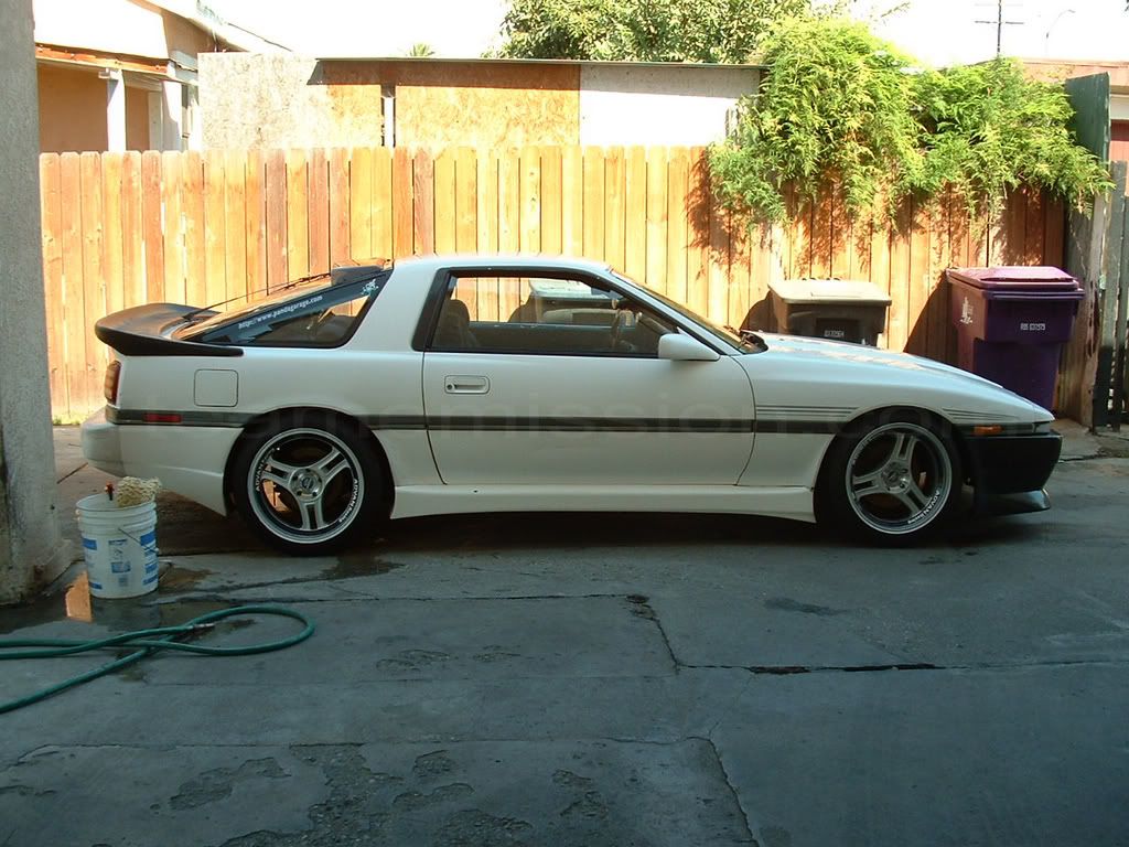

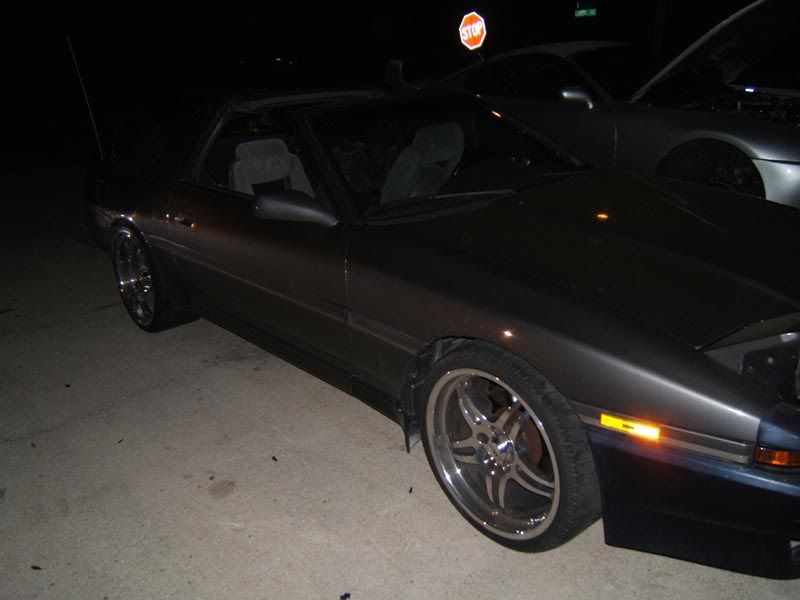

my current set up dosen't need those fender flares at all and looks awesome without them. I'll get pics tomorrow after washing, hope my new paint job dosen't peel. lol
But I did have 17x10 + 12's all around, and planning on going 10' +12's on my soapra.
After fender rolling the tire dosen't rub, and clears travel.

Emission's suspension looks okay from this view. :icon_razz

Emission, do you have a side shot of your car? I want to see how it's sitting?
