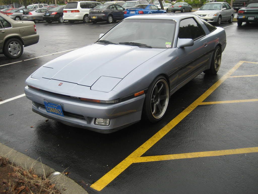

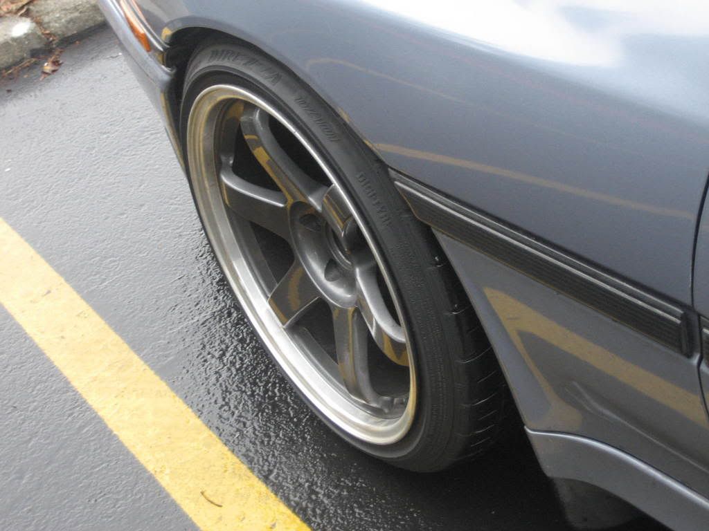

here's my setup, f 225/40 18x8 35 offset and r 255/35 18x9 38 offset. can you fit 255 on 8" wheel? i want to run 255 in the front also but not sure it would fit.

I ran 255/40 in my old setup 17x8 in the rear and it didn't look much bubbled, don't know how it would look with the 35 aspect ratio but you maybe right about some rubbing issues though.
