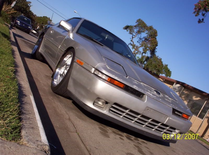

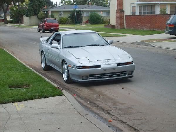

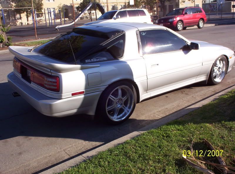

here's mine 18x8.5 +32 235/40
18x9.5 +35 265/35
The front rubs when I make semi-hard turns so I've been leaving the tems on. I have to make slow turns.

Can you expand on your rubbing issues? When you say it rubs in turns, is it rubbing on the outside fender lip or on the inner fender? What suspension are you running? Since you mention TEMS I am going to assume some springs (H&R?) and Illumina 2's? It looks like your wheels are almost up into the wheel wells, it this true?
