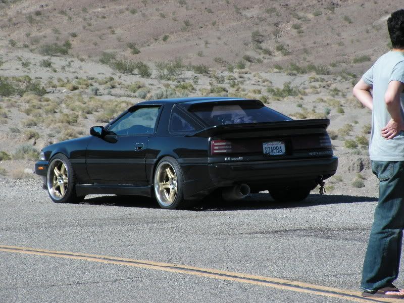

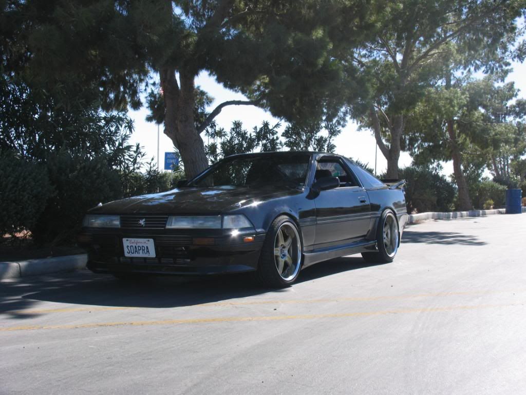

s0ulstar;799718 said:
IMHO, Jose has one of the best wheel fitment to date. the new wheels he has are awesome and the pictures posted just don't do it justice.
EDIT: i stole a couple of joe's silv pics.
Whose ccar is this. I would love to know what his suspension mods are.

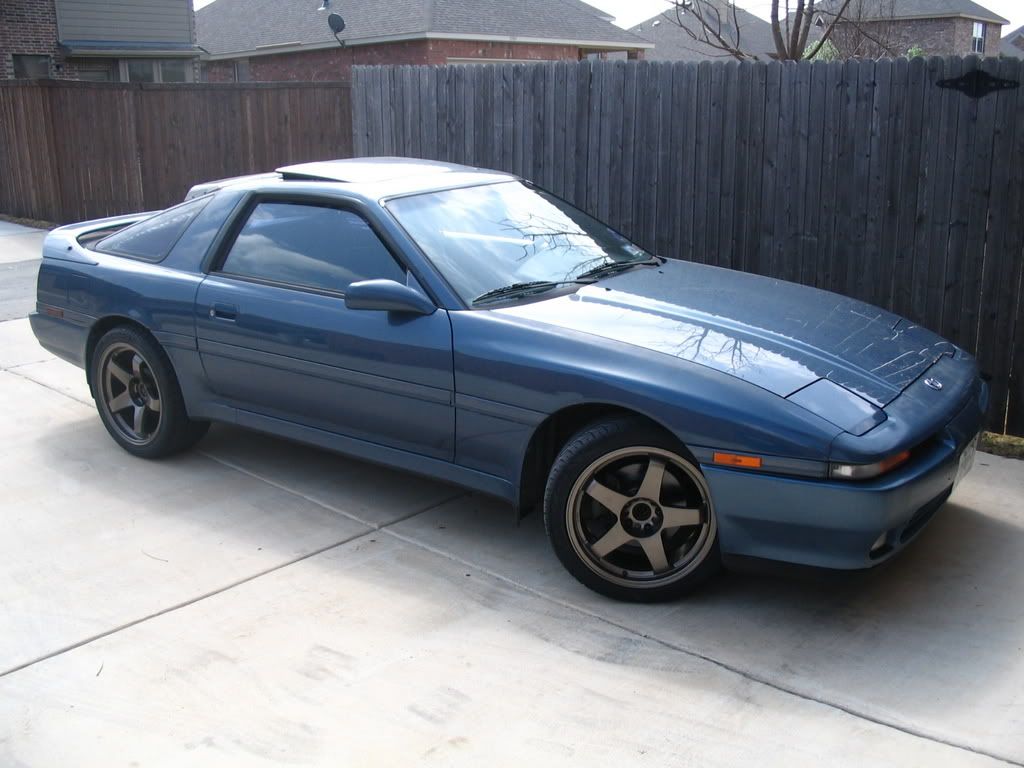

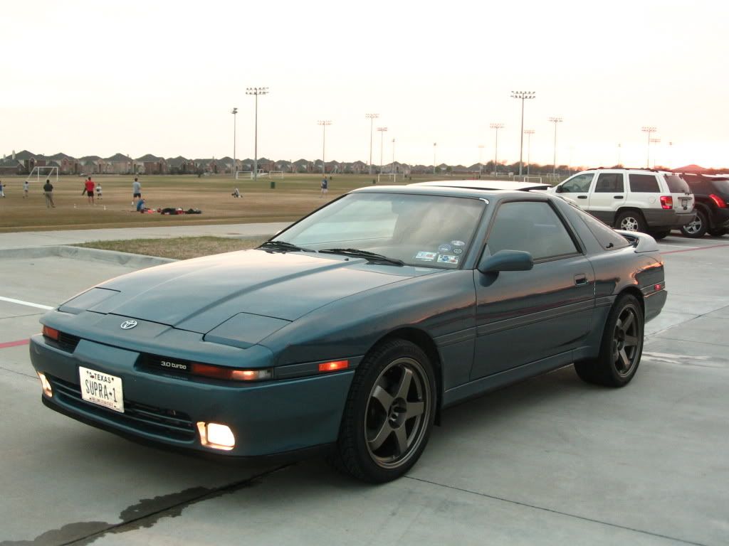

iceberg319;799781 said:
im runnin rota p45's
18x8.5 +25 235/40/18
18x9.5 +30 265/35/18
running the same wheel
rota p45f - front - 18x8.5 - 245/40/r18 +25
rota p45r - rear - 18x9.5 - 275/35/r18 +30
no rubbing left/right, minor rubbing over large transitions. This setup is very straight with the side of the car and the tires match the wheel almost perfectly.

Yup they do = / the inside rubs right? it is all smooth inside now because i was rubbing on it haha. Get some spacers ;) I have some 8mm you can have if you can wait.

I love the rears on the P45s, but I'm just not a fan of the way the spokes on the front sit....Do you have a pic of the P45s straight down the side of the car?
