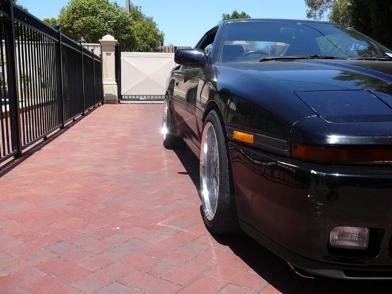

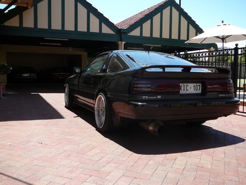

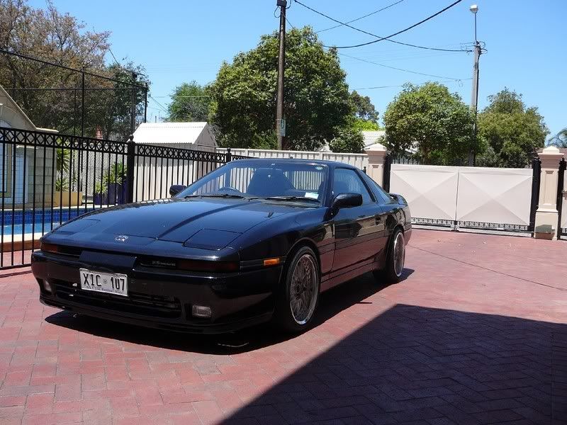

Work Reezax.
17x8 +5 17x9 +5
Don't know what tire he's running.
And those dang aussie's NEVER lower there cars enough!
EDIT: They don't really look like +5s..... hmmmm... That what the dude posted them as though. So I dunno.
