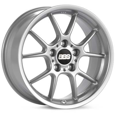

the FNoh-one-nor-see-er whatevers have a pseduo-lip... i just cant stand how the face goes from a low offset to a high offset just to bring the spokes back into the barrel. its a wheel with an identity crisis... plus, they are played.
look at some FR500 wheels in the offsets and width rodel mentioned. its similar to a nice BBS RK with their wide-split 5spoke pattern and its not played out on mk3's yet.
FR500
bbs rk
Sawbladz
