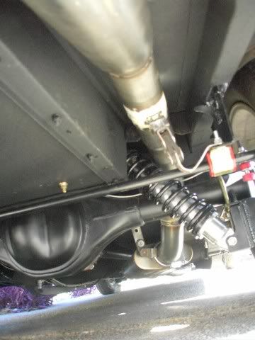

Last week we finished the underside of the car, now it's mainly just the wiring that needs to be finished along with the fuel system under the hood.

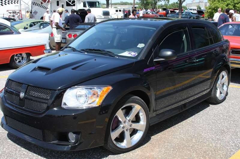

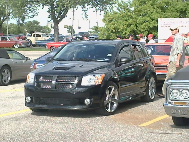

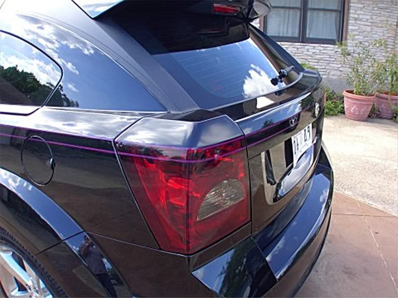

Poodles, I bought the SRT to replace my pickup, I was spending $100 a week on gas in that thing. The Caliber gets 31mpg (6 speed), handles like a dream, and the guys that have figured out how to launch them have been running high 13's bone stock. I just wanted a daily driver that got decent mileage and had some balls to it. I did some paint work to it already, but will probably leave the drivetrain stock for a while. I already have one money pit, and this Maverick will need all of my free time. I painted the tops of those big goofy tail lights body color, and tinted the rest of them. The black paint has a silver and green metal flake in it, so I trimmed it with dark purple pistripes and SRT4 lettering on the fenders. The calipers were red so I painted them dark purple too. (yep, it still had paper plates on it) It looks really cool in the sunlight.
