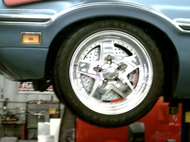

Last night I pulled the Centerline Wheels off of my MKIII to use for wheel fitment.
We ended up being able to fit a 285/18/40 in the rear and a 245/17/45 in the front.
These are the wheels that we decided on, mainly because they fit the 70's era of the body. The centers are satin silver, and we were thinking of painting the chrome bumpers to match. Sorry it's so short and sweet, but that is all I have for the moment, back to work for me!:biglaugh:

Great looking wheels! It's unfortunate they're going to cover up so much of the brakes though, because they are just as pretty:icon_bigg
Rajunz
Fast Coonass
794
Austin, Texas USA
You're killing me Jay, you know I would have given anything in the world to see you and Lewis fight it out..........................
My thoughts exactly dugums. I wanted more of an open wheel to showcase the big brake kit, but Spectre liked these most because they fit the era of the car, and also because they already have 5 cars with 5 spoke wheels. I really do like these other than that, they remind me of an old Bonneville Saltflat Racer.

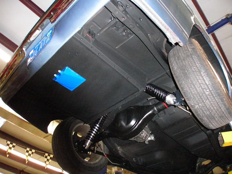

Thanks again for all of your help Jeff. JAWSGEAR helped us out tremendously on the 9" rear setup.
It wasn't the case that it was interfering with afterall. The housing itself is thicker in the center than other 9" in the shop, so we had to modify the mounting bracket.
It seems that most everything in these type of builds needs to be modified one way or another.
hahaha, yeah we find every custom diff we do that is upposed to be a stright bolt in just doesn not quite work out the way it was planned. Glad you guys got it together. Looking good.

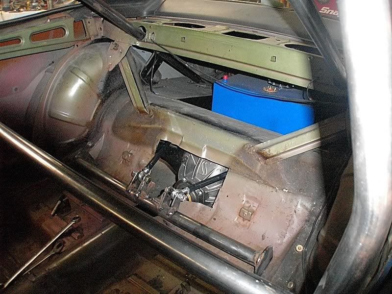

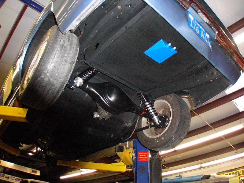

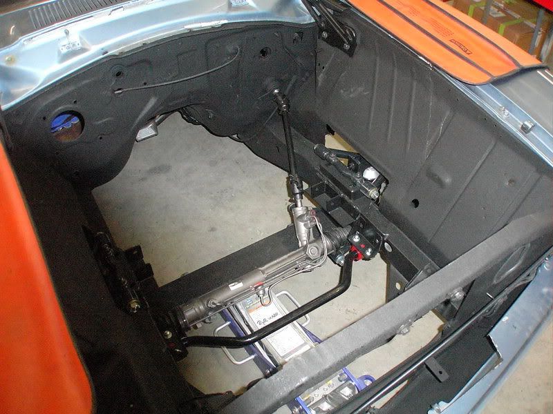

On the chassis, we've pulled our hair out trying to make the coil over kit work. It was designed for a Mustang, and sure enough, we had to do the R&D and figure out the main difference in the Mustang and a Maverick. The Mav was alot shorter, so the back seat was stuffed right on top of the rear end. We finally decided that the only way to make it right, was to start cutting. (See first picture)

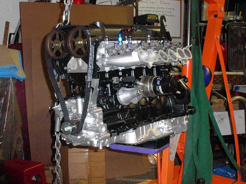

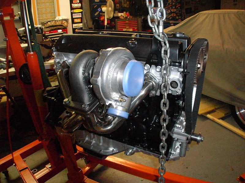

The engine is out of an Aristo, so it only took me 4 tries to figure out that Toyota made 3 different water pumps for the 2JZ, plus each pump has it's own rear housing, plus each housing has it's own water pipe. I now have 7 of the 9 components, yet in the mean time, the front of the engine still can't be assembled. Oh well, once again, today the guys at Boost Logic bailed me out, thanks a million guys. Hopefully, it goes in the engne bay this weekend.
Wreckless (Jeff) is going to fly in next Thursday and help me wire all of the Fuel Controllers, ECU, etc. into the 2JZ harness, so it definitely has to go in before then. Plus I'm sure we'll get to hang out and enjoy some Texas BBQ and hospitality.
Oh yeah, about the Purple oil pan, I brought it to the Grim Reeper to do the mods to it so that it would clear the frame rail. That's how it looked when I picked it up!:biglaugh:
