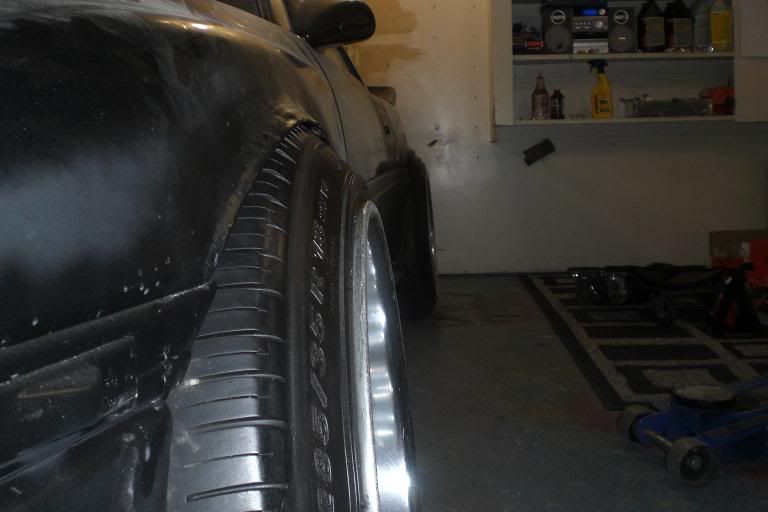

garagefujimoto;1140256 said:
I'll try a pic tonight if I get home while sun is out
18 X 13 zero offset off my Old Celsior
Put both rears on one side.
Coilovers, JIC camber arms, and pulled to the max, not chopped up
The front tires actually turn, but only because I have the fender tubs and even the lips/edges of the bumper/trim shaved for max clearance.
Only problem would be the lower control arm, I have extended rack travel with the GP Sports kit, and the bck side wheel lip hits at about 95% turn

rodel;1142832 said:
Where are the pics?
Here yah go...was sorta darkish, sucks being up north in fall/winter
Just a test, these will not be what I am going to run long-term.
[thumb]http://i167.photobucket.com/albums/u128/garagefujimoto/70-132.jpg[/thumb]
[thumb]http://i167.photobucket.com/albums/u128/garagefujimoto/70-13.jpg[/thumb]
Sell your left nut and get the S2 overs!!!!!!!!
Or pie cut those fenders and run em! Please? For me?
kbye.
why why why do I have to be so poor and in college...
I would make most of SM hate me for the things I'd do to a supra if I got my hands on another one...
garagefujimoto
Local Tire Destroyer
May 27, 2005
997
45
Calgary, Alberta, Canada
hehe... the S2 overs are cool, but then i'd have to get 14 wide rims to get the same look hahahaha
the fenders are already undergoing pie-action.
if that doesnt work out, bolt on flares a la 260Z will be the case.
I'd run em, but the actual fronts are quite narrow, and it would be costly to buy new wheel barrels/hoops to add more lip in the front when i could just get the set i wanted
plus a 12 wide with a bit more offset will sit in the same spot but allow the use of sorta cheap 265's as opposed to not cheap at all 295's
