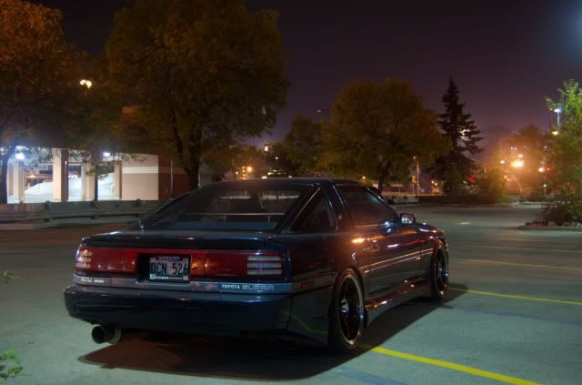

Here's some pics of my new wheels, have them on for about a month, no rubbing at all. lol of course I'm on stock suspension...and yeah I know I need a drop...it's in the works!!! :) I'll have more pics shortly...in another thread somewhere, someday lol.
Wheels are Enkei RPF1 17 X 9" +35 all around with 255/40 front and 275/40 Yokohama S-drive tires. Sits pretty flush to the fender and I could go 265 F and 285 R on those same wheels, maybe later down the road.

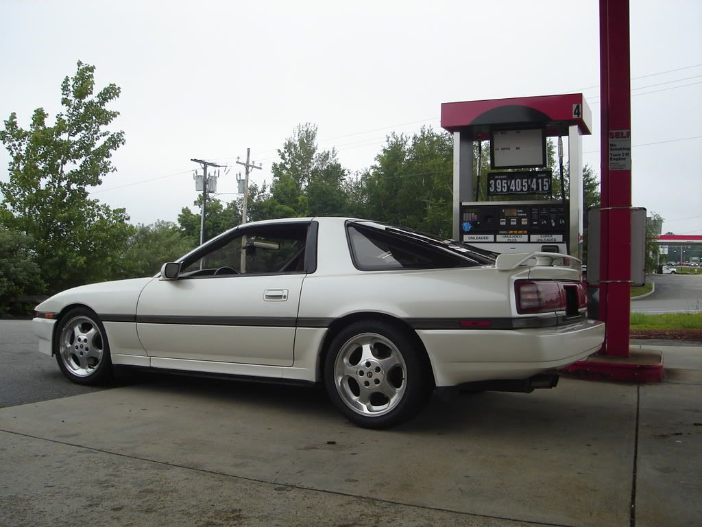

17x8 +25 all around on RS*R Race springs. No rub, great fitment.

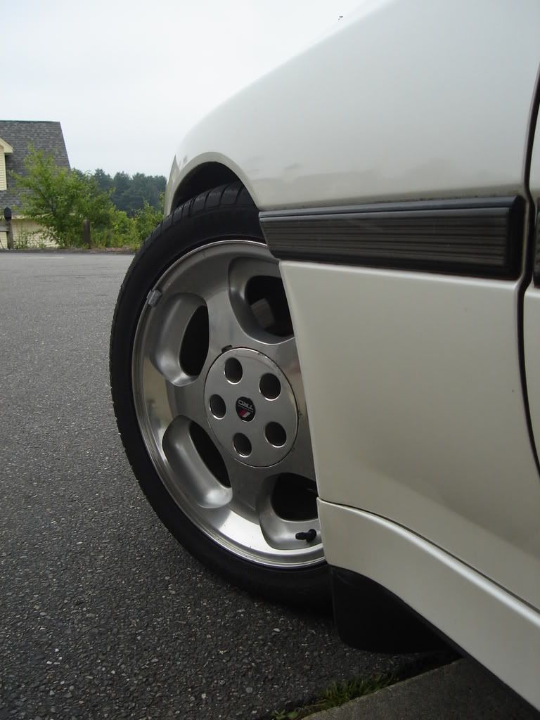

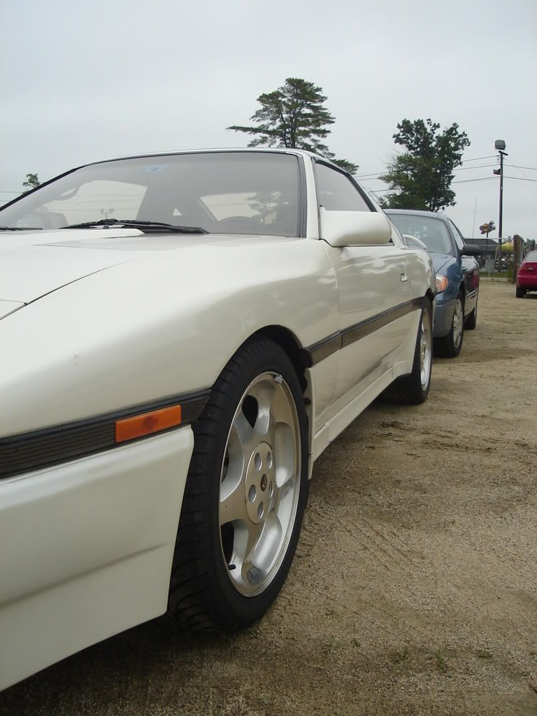

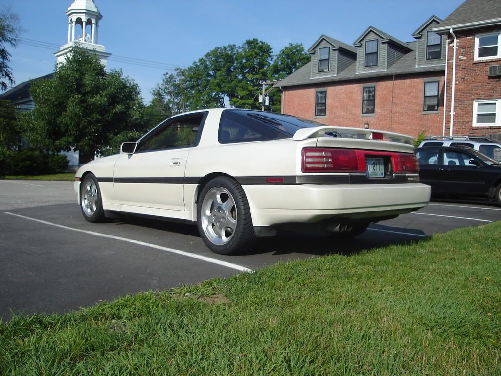

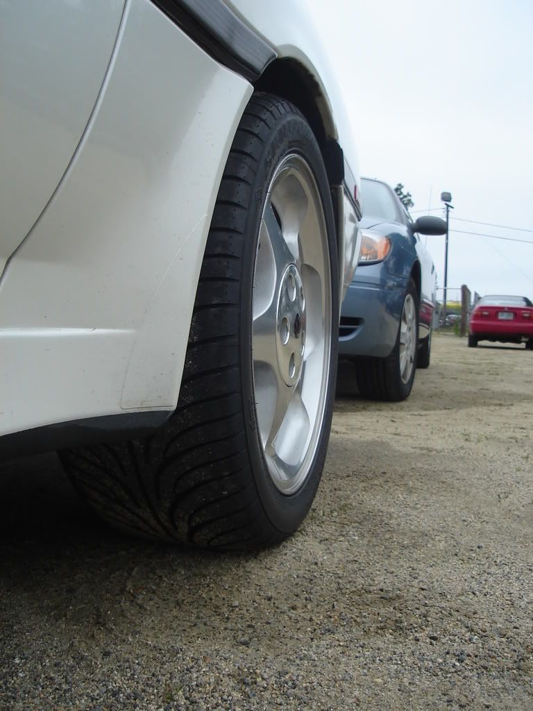

I suppose it's time I post. Not sure how it becomes a link on the first page - Boris, do your thing.
OEM Ford Mustang Cobra Wheels - 17x8 +25 all around. 245/40-17 Front, 255/40-17 Rear
No fender roll - no rub. (Just bent the fender-well tab up to the edge of the fender lip)
On RS*R Race Springs and Illumina II's
