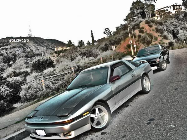

Nope you should have no issues. There are many many people running TT rims as is with around those tire sizes with no issues.
You were absolutely correct, check this out:

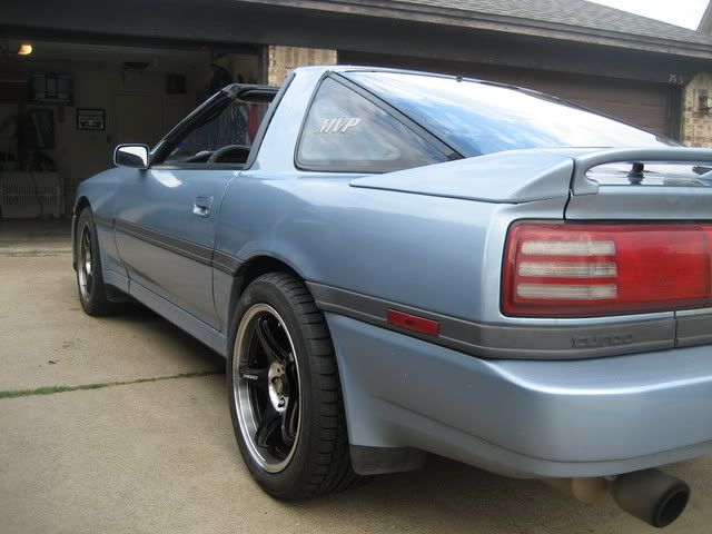

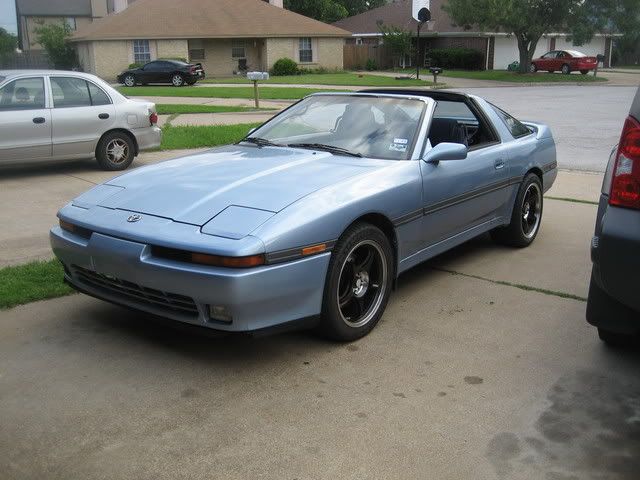

Here are mine: 17x8 +35 with 245/45/17 Kumho SPT tires and 17X10+35 with 275/40/17 BFG Gforce Sport tires. The fronts are totally flush, the rears stick out just a tad, but look so mean!
