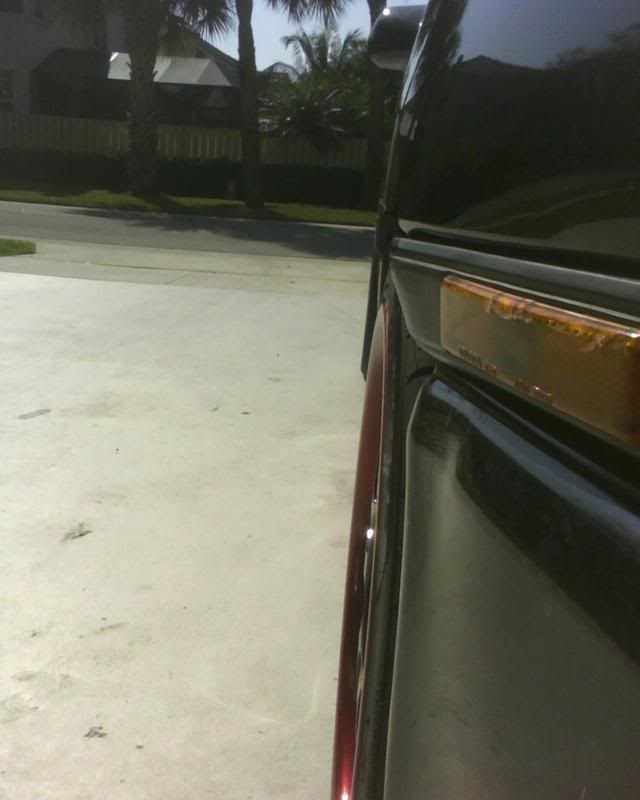

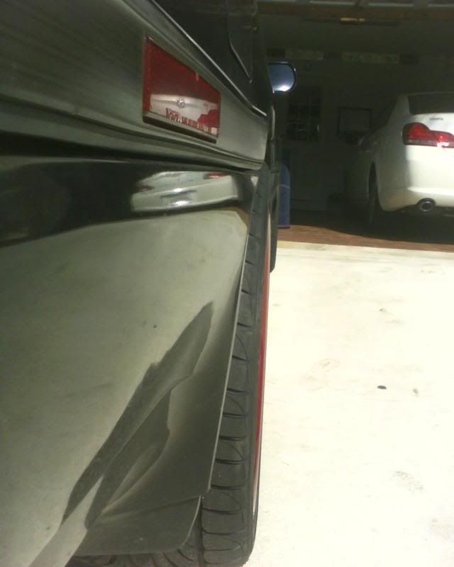

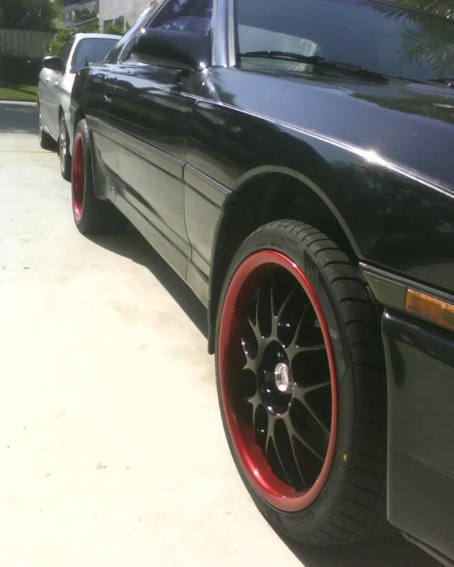

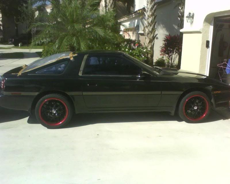

New wheels I just got. 18x8.5 in the front with a 245/35 on it and 18x9.5 in the rear with 275/35 on it. Haven't spent any money on suspension yet because my money is going towards another part of the car first. So I still have a 4x4 Supra. Sorry about the cell phone pics, my girlfriend stole my camera.
Rear wheel
Front wheel
Better picture of 4x4 action
anybody have this same setup with a lowered supra? i'm running on tokico blues/eibach pro kit...i'm looking to go 18x9.5 +35 (they don't offer any different offset :3d_frown:) all around. or would 8.5 in front and 9.5 be better? anybody feel any difference in staggered vs same all around?

BorHor;907162 said:
Third post. I had the same size and offsets.
duh! i went down the list a little too quickly...the first link slipped me. lol. should i pick up the 9.5 all around or would 8.5 up front be better?
