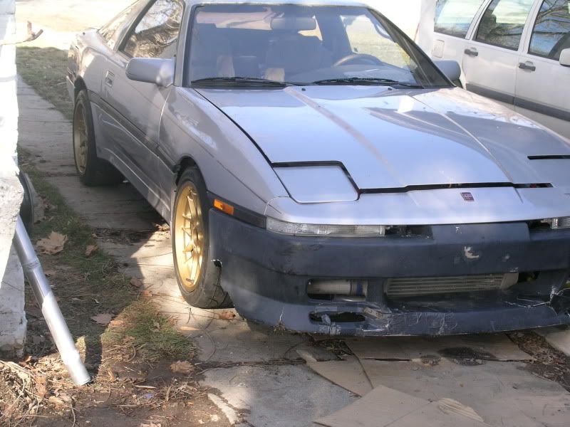

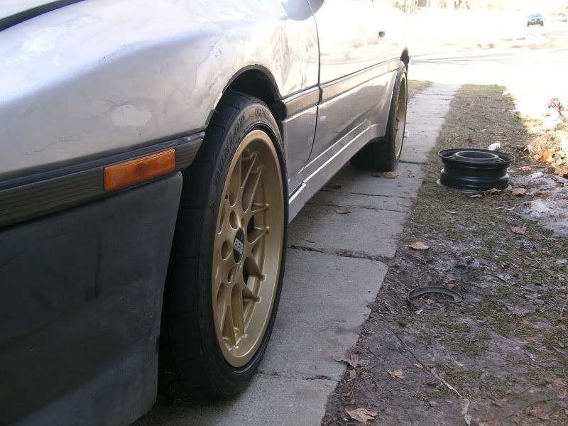

toyolla86;1665200 said:
heres mine with my bbs wheels. i have yet to see any supra's with bbs's although im new here so i could be entirely wrong.
car needs lowering really badly.
17X9 ALL AROUND ET28 (offset) powdered coated.
This is what I am planning also. Would you make any changes if possible? Did you end up lowering your car more and did it rub, thanks

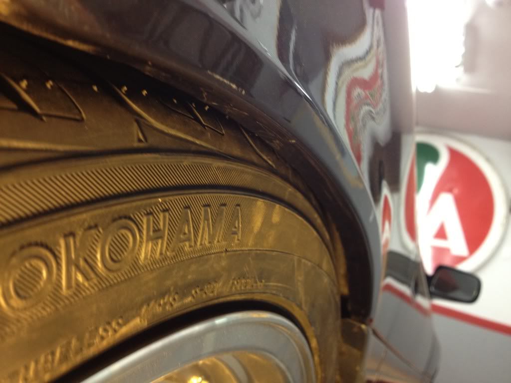

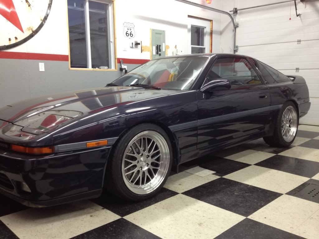

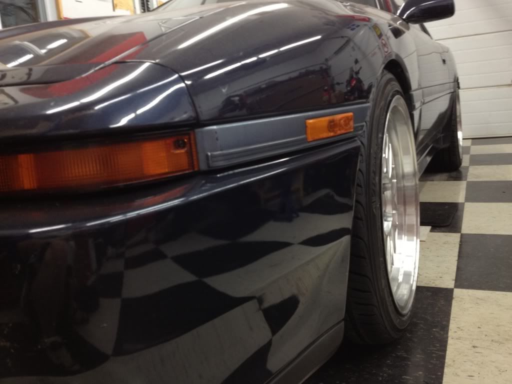

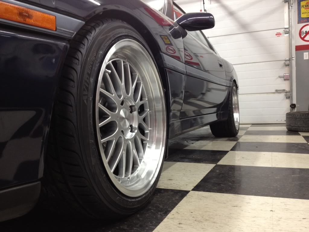

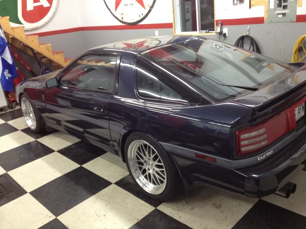

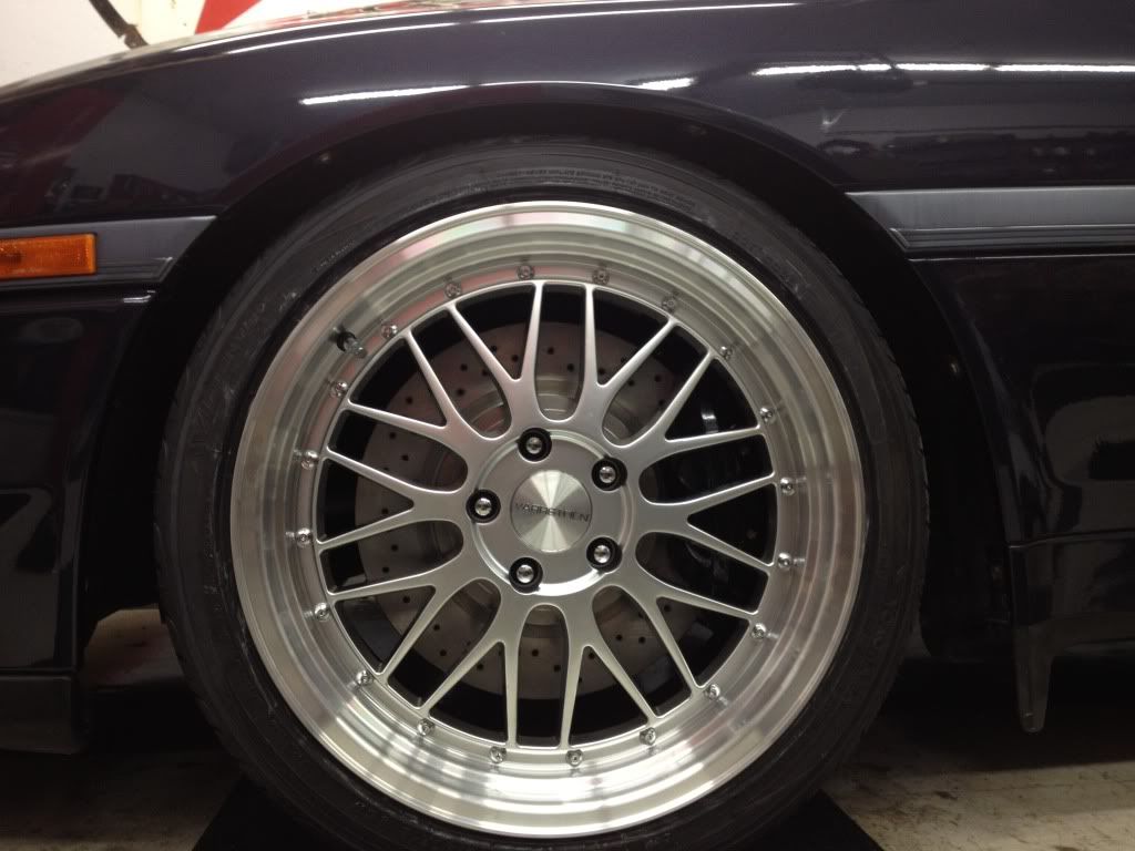

Finally, i received my wheel.
Model : Varrstoen 1.1.1
Rim size for all 4 : 18, 9.5 width ,+30 offset
Tire : front 235/40/18 Rear 255/40/18 Yokohama avid enVigor
In front, I will need to roll...or push where the 2 screw tighten the plastic inside guard and it should be ok, I hope.
In rear, i'm not sure at all. I tried to compress the wheel and it look like it will clear. I also tried to jack the car on the opposite side to compress the wheel but it look it doesnt camber the same way so I dont know if its a good test. Let me know please.
I would also like to know if i should keep the rear wheel that size or go with the 245/40/18 instead of 255. It would help to clear the rear lip + car height will be more even front to rear.

How much is your supra lowered by? or distance from ground to underside of chassis rail. Cheers, fitment looks good to me, nice and flush without being too extreme
5 1/2 in front and 6 1/2 in rear (in front of the rear wheel). This is from the ground to the lower part of the chassis (the lip)
The difference is due to my rear tire being taller

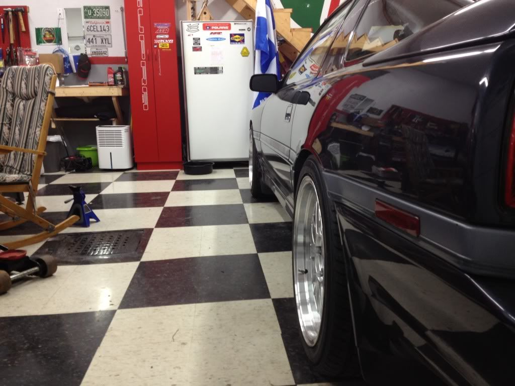

OK guys. I have a question. I finally found pictures of the rims I want on a MK3. I forget who is the owner of this car, but I know he posted in this thread. Basically I want Work Emotion XD-9s in 18x10 front and rear. The only thing is they only come in +38 and +18. This guy is running +38 front and +18 rear, my question is, can I run +38 front AND rear? It seems with the +18 in the rear, he is using very stretched tires, and I don't want to do that. I want to run fat tires in the back, so I figured +38 front and rear will allow me to run that fat tire in the back. Do you guys think this setup will clear a shock/spring setup with rolled fenders? I want to avoid pulling. Here are pics of the other guys setup with +38 front and +18 rear:
oh yeah, the suspension will be tokico illumina 2s with RS R springs.
