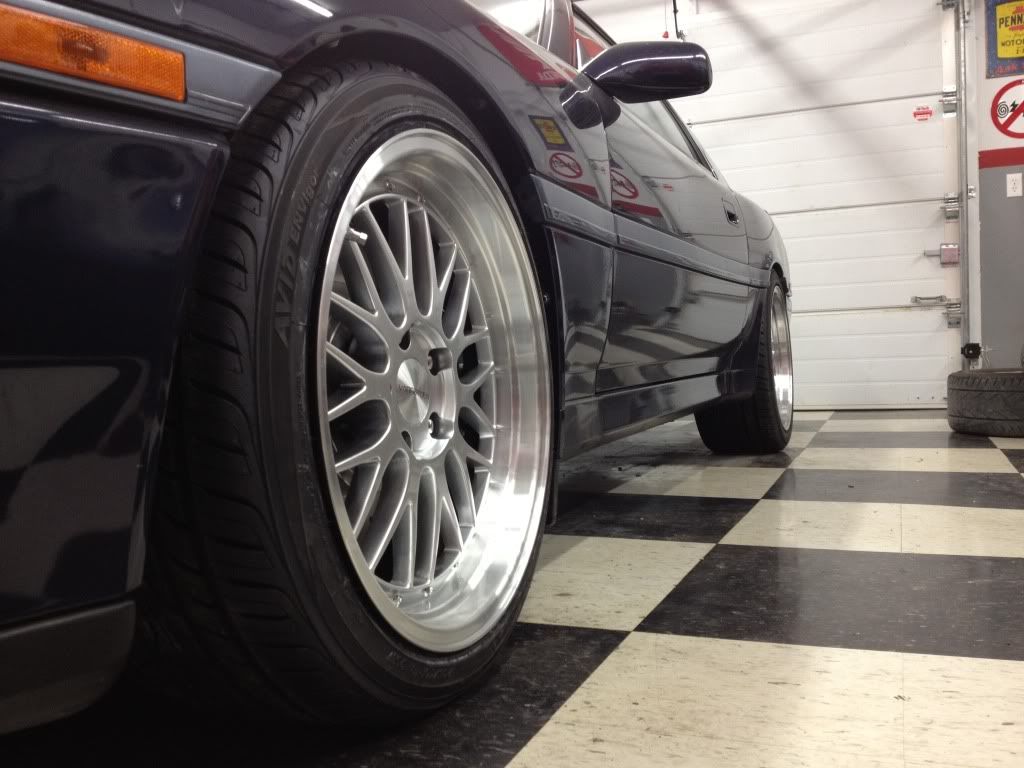

lithium14;1849817 said:
OK guys. I have a question. I finally found pictures of the rims I want on a MK3. I forget who is the owner of this car, but I know he posted in this thread. Basically I want Work Emotion XD-9s in 18x10 front and rear. The only thing is they only come in +38 and +18. This guy is running +38 front and +18 rear, my question is, can I run +38 front AND rear? It seems with the +18 in the rear, he is using very stretched tires, and I don't want to do that. I want to run fat tires in the back, so I figured +38 front and rear will allow me to run that fat tire in the back. Do you guys think this setup will clear a shock/spring setup with rolled fenders? I want to avoid pulling. Here are pics of the other guys setup with +38 front and +18 rear:
oh yeah, the suspension will be tokico illumina 2s with RS R springs.
Wouldn't it be practically the same, just on the rear 20mm more towards the car?
hvyman
Dang Dude! No Way Man.
Apr 17, 2007
12,568
Fullerton,CA
Yes it would. Too high of a offset with a 10in wheel will rub on the shock tho.
I have 18x10+25 with a 275 and I have atleast a inch and a half maybe 2in but I have coilovers and there slightly skinnier than spring/shock iirc.
