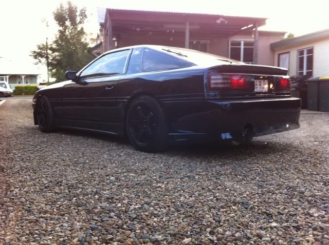

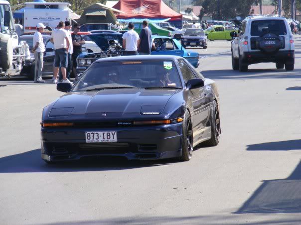

thanks guys. Yes I agree the front could be a +30 with that tyre size i recon.. but it still works great.
nothing with the fenders, only rolled the lip up.
Im on HSD HR Coilovers. Soon to be other gear going in so I can have more front negative camber and tighten it all up.
The Aerokit is some Tracer sideskirts and rearbar. Front is pre 88 conversion nose with a fibre glass 32gtr front glued on.
Had it like this for Years. :)
Always seems to get a look.
wobssorc
Jul 27, 2011
25
Bundaberg

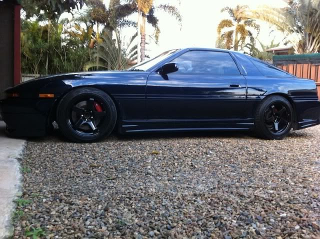

for those wondering, I normally roll like this:
Koya Black Driftteks
Front - 17 x 9.5 +18 235/45 tyre @1.75deg neg camber (its nice and flush)
Rear - 17 x 9.5 +18 235/45 tyre (this is sad I know, I am literally going to price some 255/40 or 265/40 tyres now!) so dont hate!
^^^ This is one of the best pics that shows the fitment... its a bit dirty in this image.
P.S. you may have seen these pics before as i have put them up on a thread somewhere.
thanks

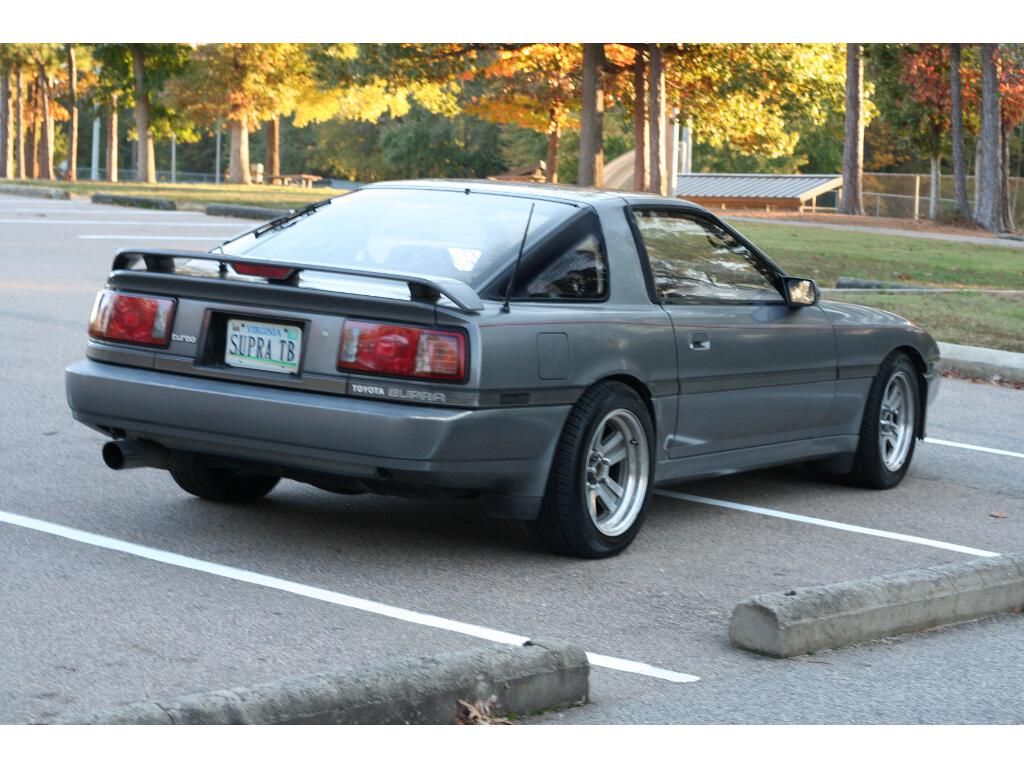

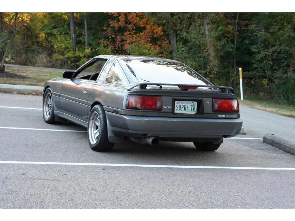

I did some researching and can't find the answers I'm looking for. I picked up a set of Starion wheels in 16x7 and 16x8 (factory offset, I guess...) and have my 225/50r16 Sumitomo's mounted on them. I have the 7's on the front and 8's on the back and they rub (ONLY IN THE BACK SO FAR...) when going into corners, on a dig, and uneven pavement due to the staggering. I am lowered using the Eibach Pros and Tokico Illumina IIs which is not an unusual setup on here, and yet I can't figure out how other people can run these wheels without rubbing. I checked all the local performance tire shops, and they tell me that 225/50r16 is the lowest size I can go on 16x8's. Is that actually true?

You could go all the way down to 205 on an 8" wheel. The tire will have a slight stretch. No stretch on a 215
