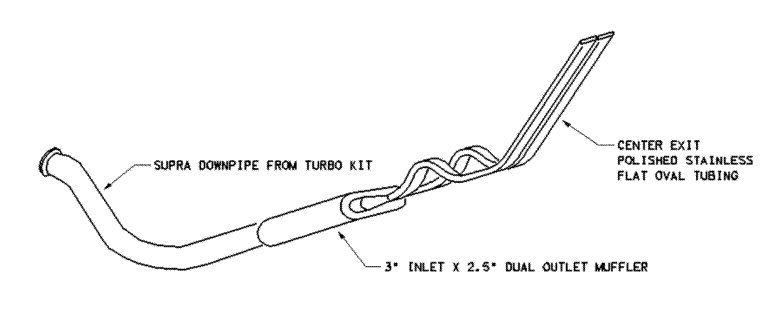

...........and I get my exhaust system that I designed.
This:
Plus this:
Equals this:
It will be center exit, under the fuel tank, all polished stainless. The car should have a sound all it's own.
This:
Plus this:
Equals this:
