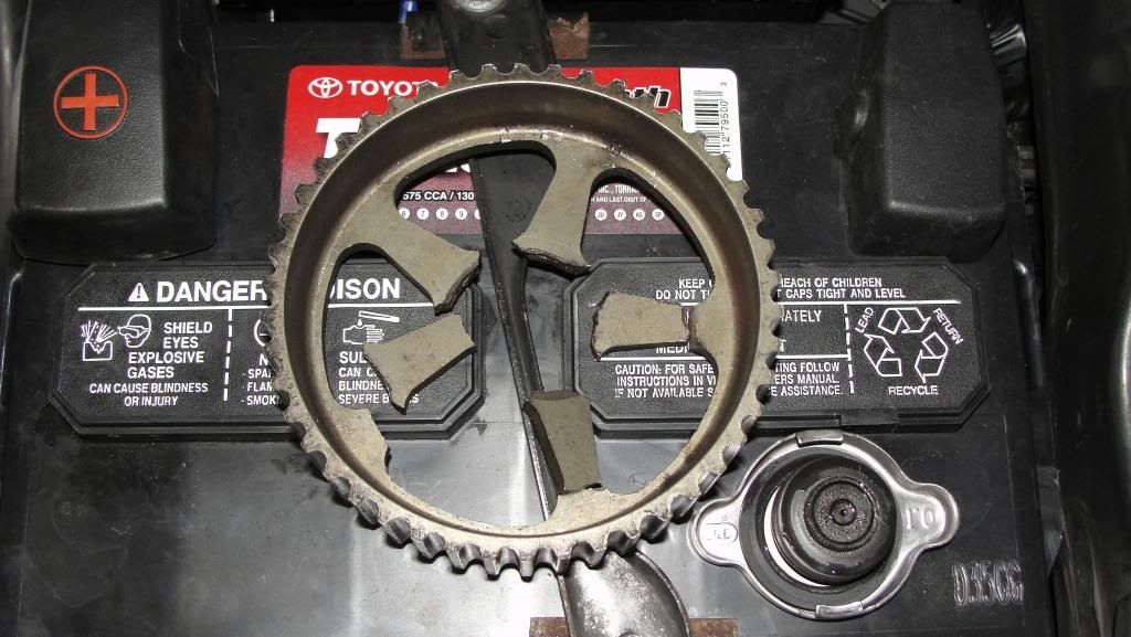

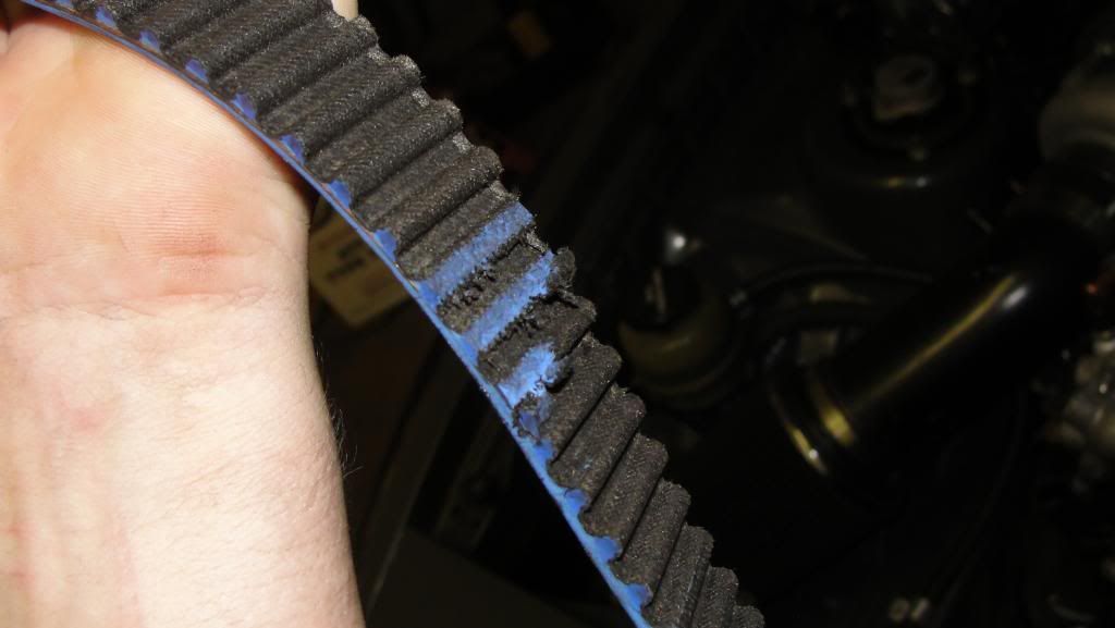

On our way home, just as we get into open country, the engine dies suddenly. Try to restart but its cranking very quickly, indicating lost compression. Pull over and pull the timing cover off and find a timing belt with slack NOOOOOOOOOOOOOOOOOOOOOOOOOO!!!!!! Got it towed to a friend's house to wait for pickup.
Fast forward to 30 minutes ago, I pulled the front end apart and got the timing cover off- found this:
and this
The oil pump drive is free and has no catching that I can detect. The only realistic cause is the force of driving the cams (272's/dual springs) exposed a weak point/ fractured a stress riser on the sintered pulley. Not fun.
So the project now, is to find an upgraded oil pump pulley or buy a brand new one and have it treated to reduce the change of failure. I have no idea if the valves have been bent as a result of this, but either way I'll find out and fix it. Kinda sucky, but it's a car and it can always be fixed!

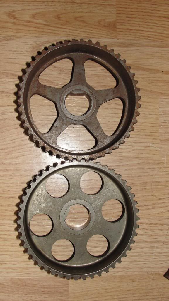

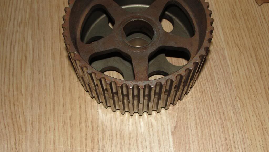

Nah, I have a spanner wrench to use that holds the pulley nicely. It's the one we use at the dealership, but it's possible that the stress riser was caused by it, seeing as it's not the exact Toyota SST. Dunno, but I'm not finding much to replace it aside from another factory part.
What are your thoughts on the older style 6-hole pulley vs this 5-spoke one?

Thanks to Rabid Chimp Performance, I have a new 5M oil pump pulley in my hands! I'mma pull the timing belt off tonight and compare the pulleys to ensure they're the same, but pending I'm able to pick up my new timing belt the car will be driveable tomorrow! (I'll get pictures comparing the two when it's apart)

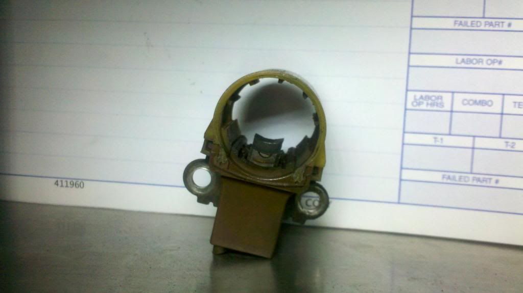

Found out why I'm dropping volts at higher rpm's, alternator brushes were pretty worn.
For reference, they should reach about 2/3 of the holder diameter across D: It'll take some time for them to break in, but shouldn't take too long.

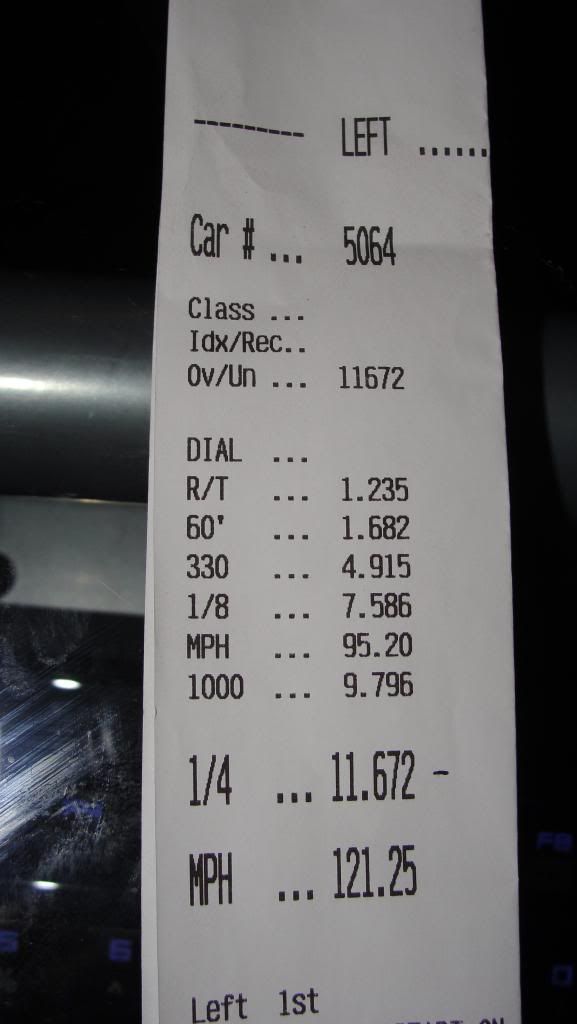

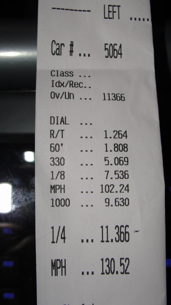

The car has been raced, but I didn't get kicked from the track. We got rained out Sunday so I wasn't able to improve on anything.
Ran an 11.3 @ 130mph with a 1.8 60'

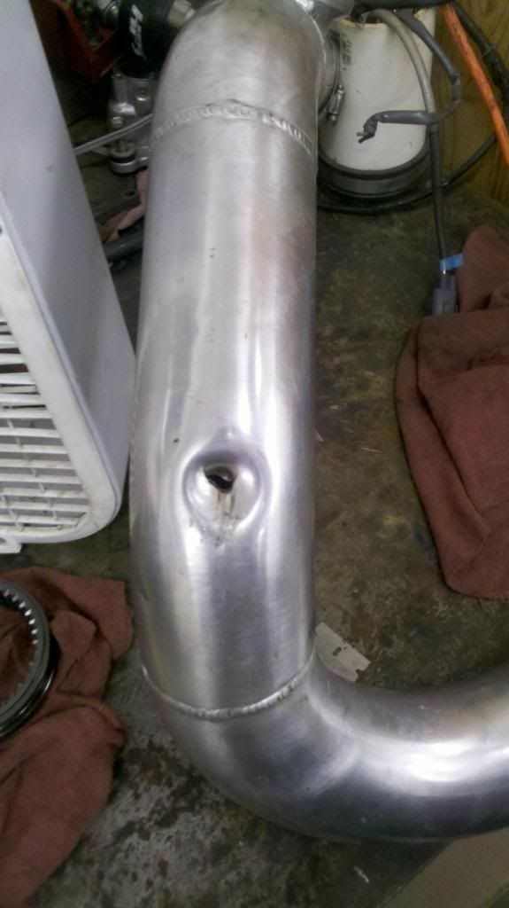

In part, I'm disappointed; because I wasn't able to get a good launch with good shifting. When I launched well, I shifted poorly or missed gears entirely; and when I launched poorly, I shifted just ok. Oh well. Car was losing power and after checking the datalogs, I found out why- 190*f IATs. Guess the ebay intercooler isn't dealing with the heat/power too well. Oh, and I need a new differential...again.
But overall, I'm very happy. Mainly because the car ran well and I was able to get some mid 1.6s 60' launches on the lower power tune, and even a 1.662 on the high power after getting used to it. Ran a time that would otherwise get me booted, and had a whole bunch of fun with friends.
Pics and videos are being uploaded soon.
Low power best run
High power best run (ironically, the first run)
