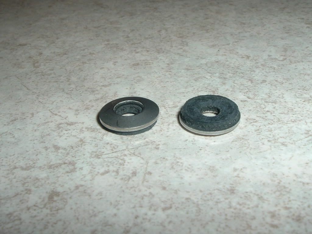

I used a washer with a grommet already attached to it. I picked up a package of 100 so I have extra if I need to replace them.
You probably will.........
I tried those stanless washers with the bonded rubber (of some sort),
and the rubber gave up the ghost in less than a month.
What ever it is, it isn't compatable with engine bay heat & oil.......
I use the ones I have left over for holding the license plate on,
they work for that just fine.
And now I only use the Toyota ones for the cam cover bolts.
Yep I have read about that happening too. But so far so good, they have been on 7m for about a year with no sings of fail yet . When they fail I have more unless I just order some new Toyo ones.
Where did you buy yours?
I got mine from McMaster-Carr.
Maybe they didn't use the correct 'rubber'............

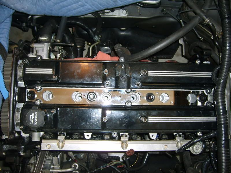

Alright, so I ordered a set of felpro grommets, and a 14mm hex allen socket. I plan on using the same bolts (philipps type) and using med strength loc tite (blue). I am also replacing the no.3 valley cover with 4 gaskets from napa. Hopefully all goes well here.
PROJECT N00b
XBL: Mkiii DriFt3r
May 22, 2005
1,660
honolulu, california
So far, no oil what so ever coming out of the SP valley, and nothing coming out of the sides. However, there is still smoke coming out of the engine bay, it's from the oil that is on the heat shield. I don't know if it is residual, but I'm going to the wash and I'm going to power wash the area. I also bought some UV dye to put into the oil. I hope i fixed the leak.
Yep I picked up mine at the same place. I just used a inch lbs. torque wrench to tighten them and every thing was go to go. Plus new cam cover gaskets from Toyota. Maybe people are over tighting them causing them to fail so fast?

UPDATE: Added UV dye to oil after valve cover fix, the leak is still there. After searching on other causes to the leak, and possible problem areas. I found that the cam seals tend to go bad. I began removing the timing belt cover and the cam plate...low and behold the cam area was glowing! I'll be going to Toyota tomorrow and try to get me some cam seals, if they are closed, I'll go to Shucks. Hopefully this is it.
