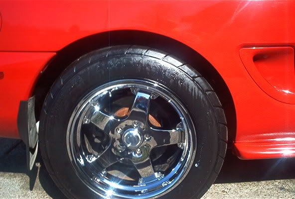

this is what 275/50/17 looks like (on a mustang):
...and you want to match that up with 255/40/17 in the front? Here's what 255/40/17 looks like (all around):
I rather see something like this (245/40-17 front, 275/40-17 rear):
