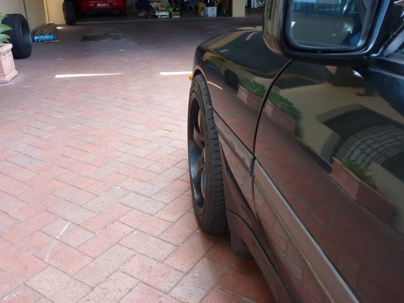

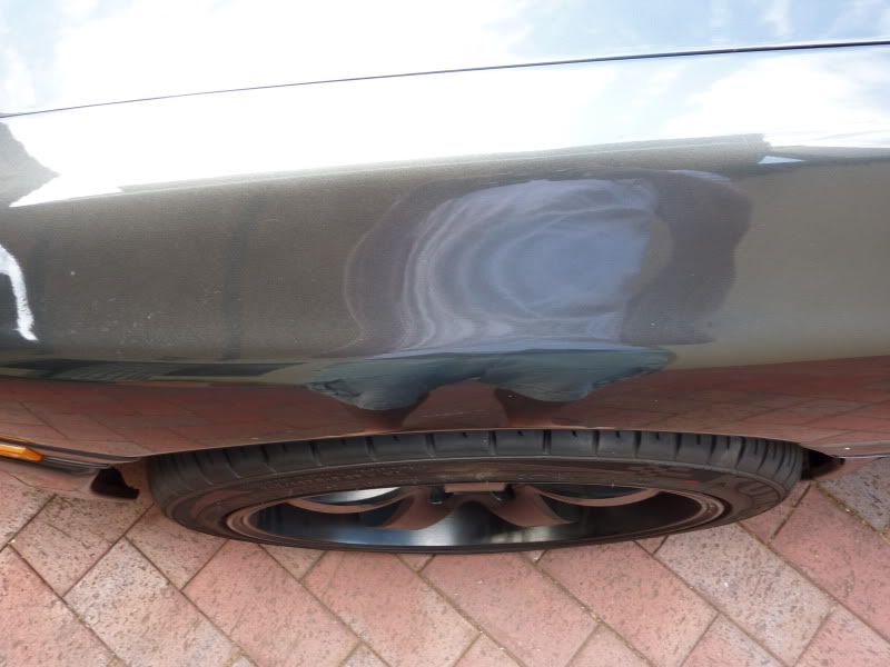

i'm running a 245/40/18 up front with a 9inch wide +15 offset wheel and the car is fairly low and here's how it sits...
if you want a 4x4 then i'd recommend the tyre sizes you suggested but until you drop your car considerably, the offsets that you mentioned simply wont work, at all, no matter what tyres you go with.
FWIW i was actually going to get 5-7mm (if feasible) machined off the centre of the wheels to make them a +22 and my estimates tell me they will sit very nicely but my car is a lot lower than stock.
