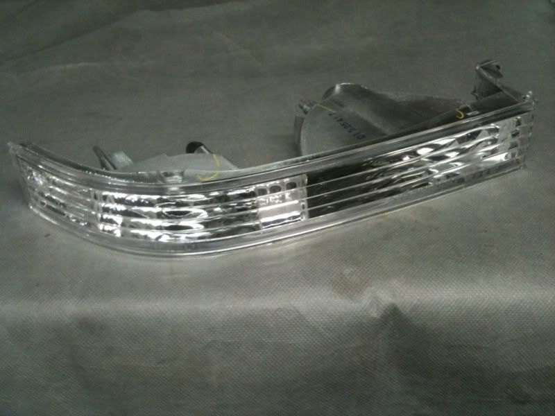

Clear turn signals. I'm definitely going to tint them. Need to get some VHF nightshade.

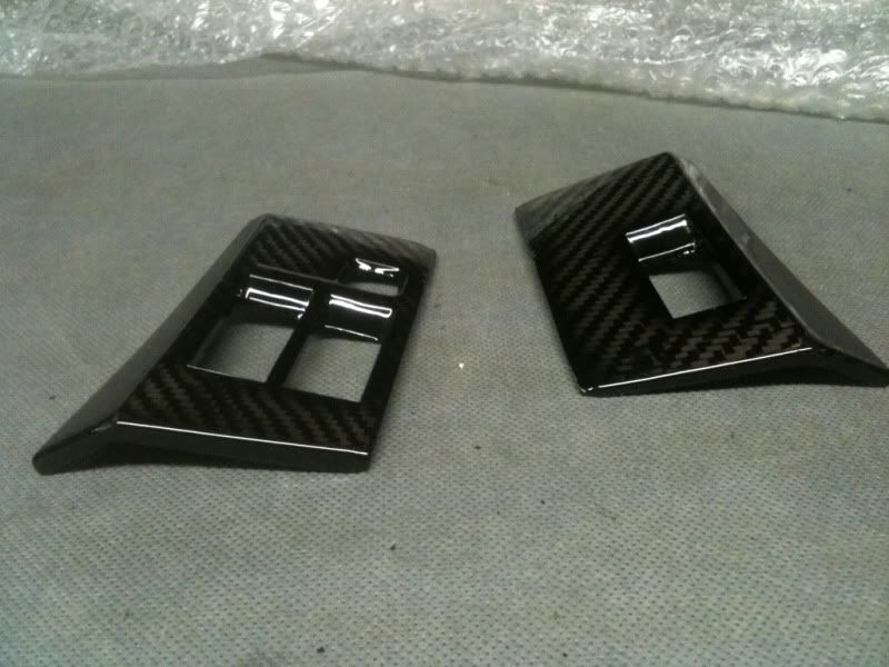

RazoE;1779114 said:
to get these to fit right, you'll need pre-89 door handles...
89+'s are a bit rounder (and the passenger side switch moved position, but it swaps right in)
Thanks enrique! Yea I noticed the ds not fitting properly. I hadn't tried the passenger side yet. Does it go over the stockers or does it replace the stockers cause they don't have the tabs to snap on.
i was thinking about doing that too, would probably look good, white car tinted turn signals to go with the gray trim and since my gunmetal rims are almost exact with the trim but i think i would need clear side markers all around too

you also need to attach the stock passenger switch mount somehow. I cut the stock one off with a dremel and epoxied it onto the retrospec part. also, the retrospec part will need a bit of sanding to get it to fit right. i used velcro to attach mine.
pics are in my build thread of what I did.
I actually saw tinted on a white supra and thought it would look good on my car. lol.
hmm. will check it out. thanks!

Yeah, they're overlays. I held off on getting some until they make 89+ versions..
You can technically use a stock pre 89 passenger bezel and dremel the upper left corner down a little to shape it...
Pre 89's had the passenger switch on the right side of the bezel, and on the left on 89+'s (not sure why toyota did that), so you can't just simply trim the CF piece to fit the 89+ bezel without major work.

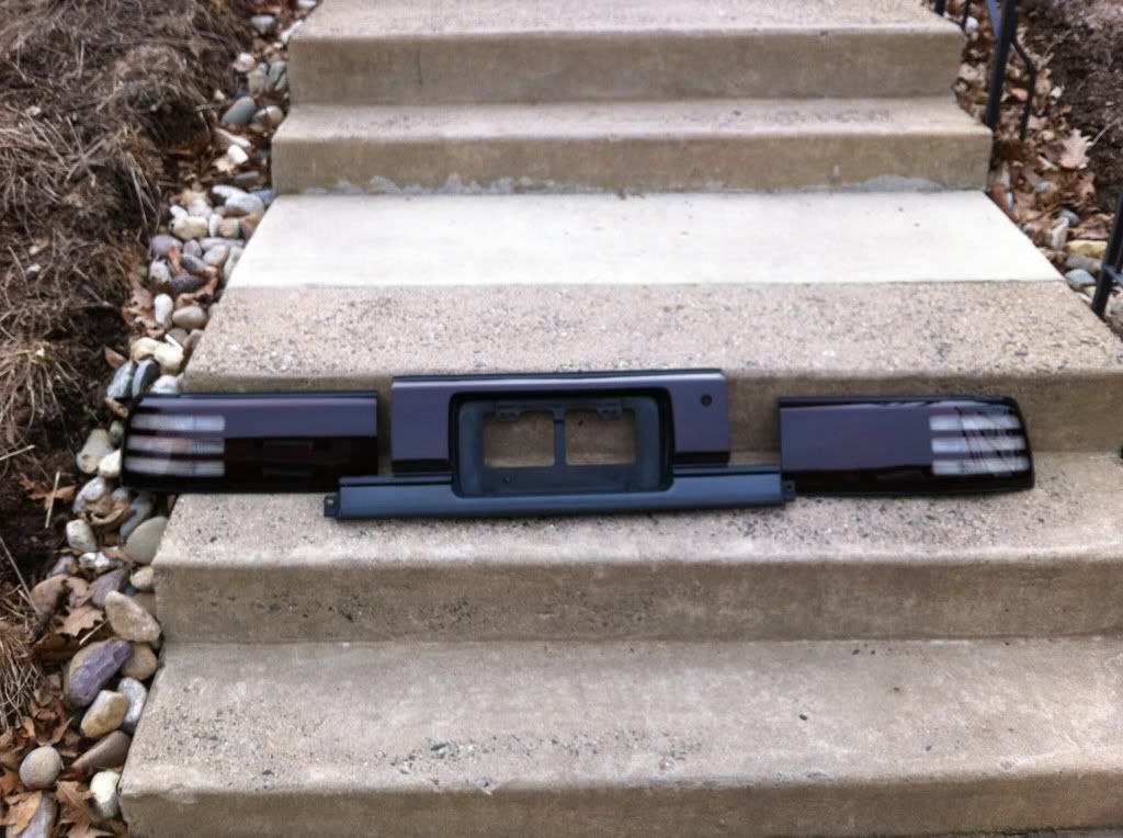

Car has been tucked away for the winter. Been doing some little things here and there. Finally started pulling the rest of the interior so I can finish dying the interior black. Bought a Kicker CVR 10" sub for a little thump thump! Gonna start making an enclosure for it soon. I'll post pics of interior soon.

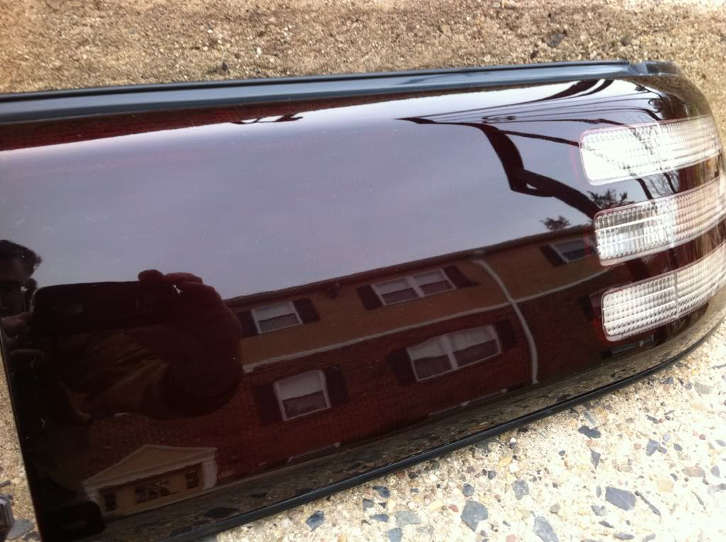

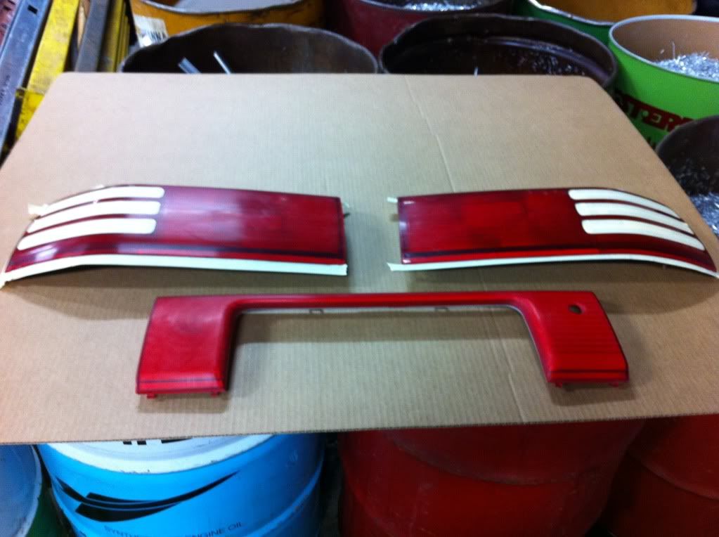

Took off my tail lights to have them polished and smoked by Gaboonviper. I've only seen pictures that he sent me so far but they look awesome! Can't wait to see them once I put them back on the car! Thanks Ty! pics of them on the car to come soon...
http://www.supramania.com/forums/sh...-3pc-tails....was-rather-proud-of-the-outcome.
