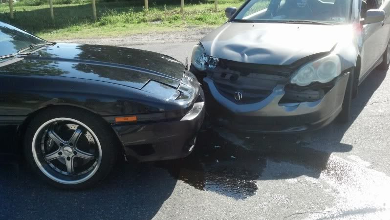

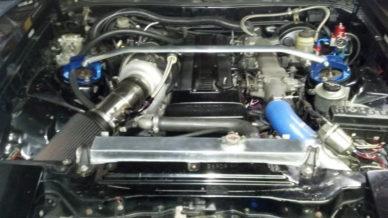

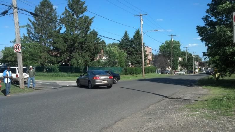

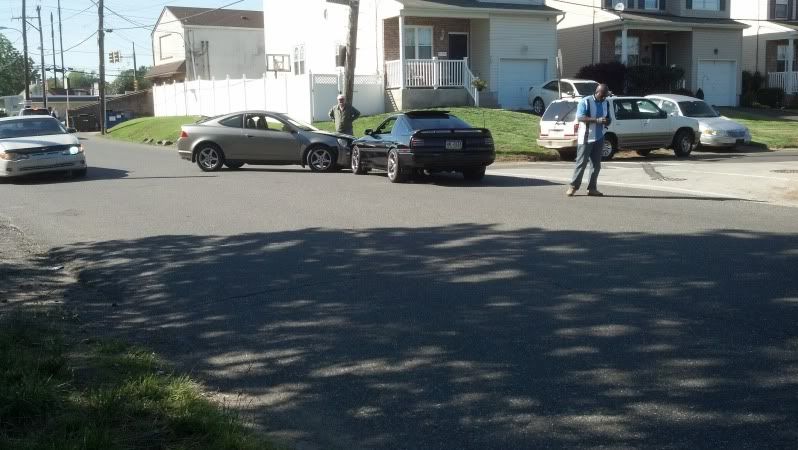

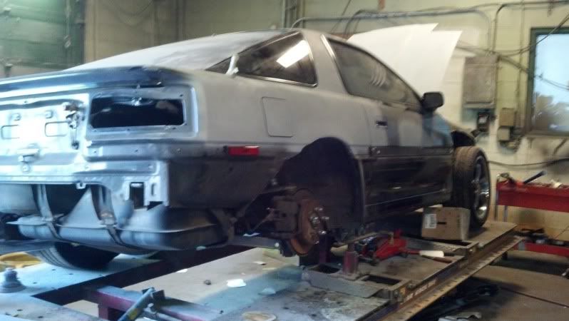

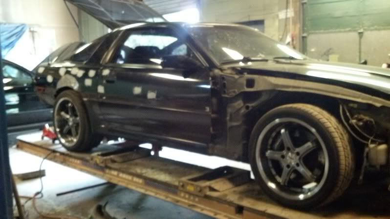

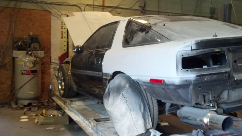

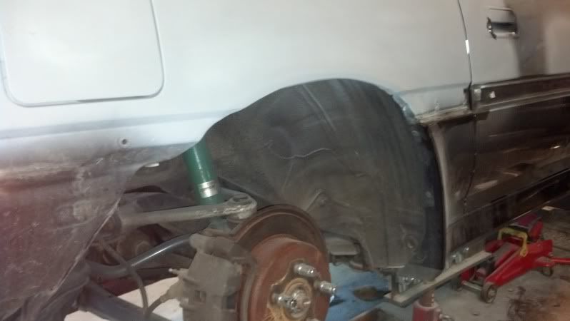

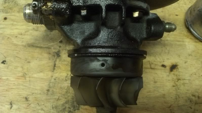

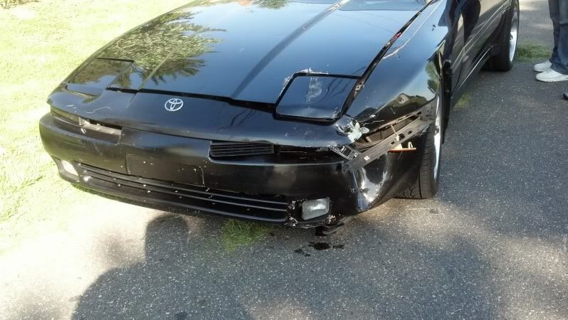

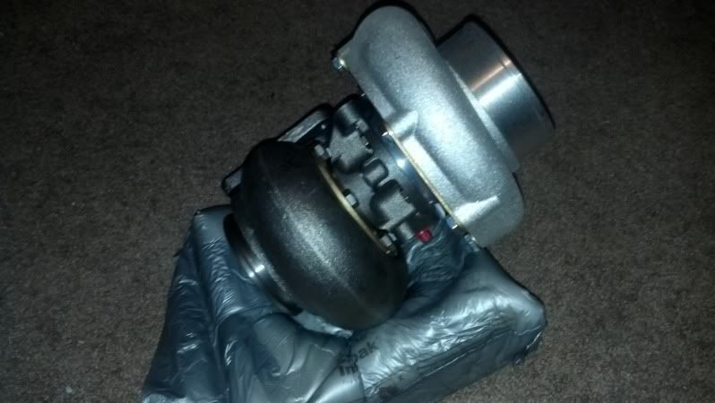

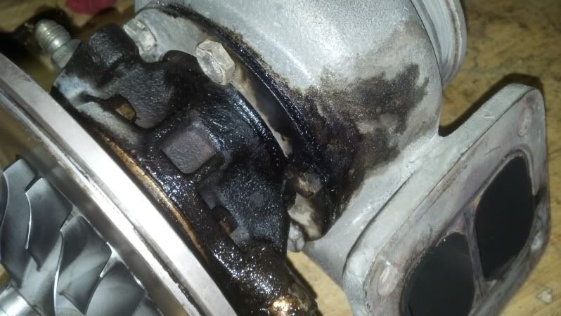

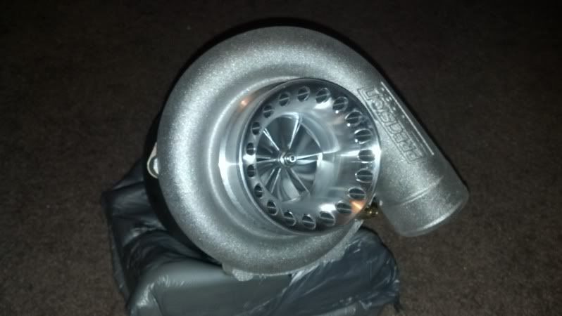

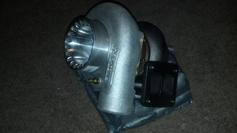

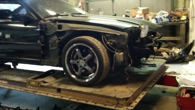

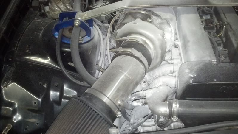

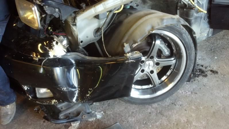

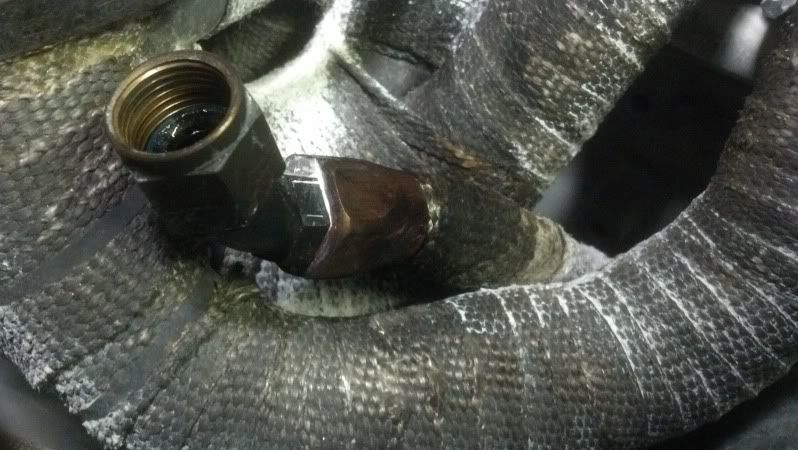

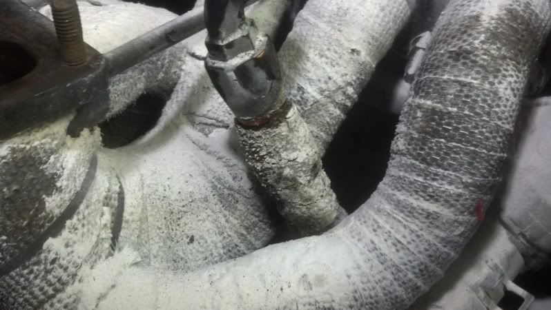

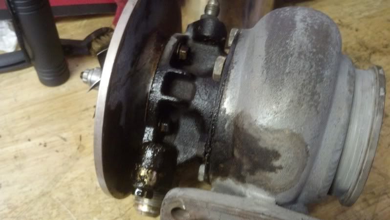

So A LOT has happened since last update.... from engine bay catching fire to finally getting tuned and getting into an accident. Right after attemping to get the car tuned, there was a fire in the engine bay under the turbo. Luckily I caught it in time. Turned out the turbo drain line melted and caught fire. I got the fire extinguisher out of the back and put out the fire. Cleaned up. Replaced the drain line with a SS Teflon (PTFE) -AN hose. and wrapped it with extreme heat protection. Raised the turbo so I could re route the drain line away from the heat. Powdercoated my valve covers. Around April I finally got the car tuned by Garth and Undercover Performance. While I was there I found that my turbo was also leaking oil and smoking. Ordered a new Turbo. Precision 6262 CEA Journal bearing. .84a/r exhaust. Car drives so much better now. Went to the Philly Supra Meet and afterwards got into an accident. This old guy turned in front of me trying to turn onto a side street. Police came out and wrote up a report and went through the guys insurance. So now the car is in the body shop getting fixed plus extras. ;) Pics to come.
supra1008
May 2, 2007
1,179
Philadelphia

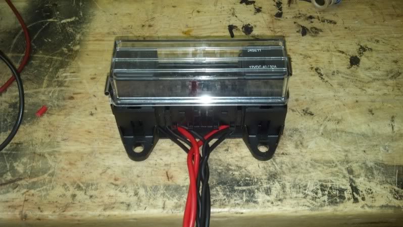

made a harness for my fans relays.
New turbo installed
Just get it running and old guy decides to turn into me trying to drive onto a side street and hits me.:nono:

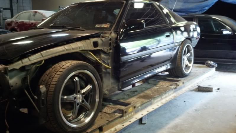

Had to get it towed since the accident caused one of my oil lines to leak onto the floor. Had it towed to a local body shop.

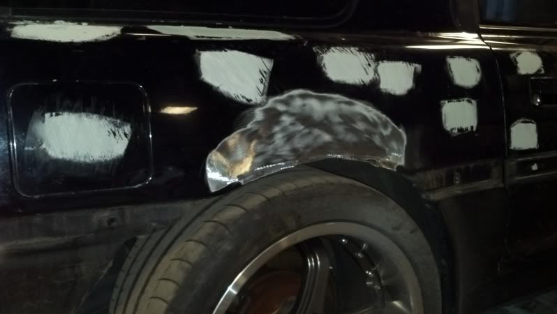

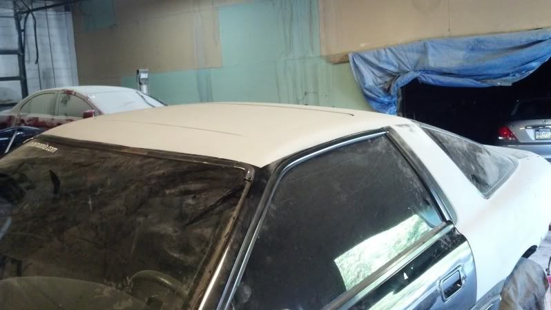

I've decided to get the whole car painted. Get the rust taken care of also. :)

and part numbers and pricing for the front windshield molding and hatch moldings
windshield:
75531-14150 $39.62
75533-14170 $27.46
75534-14140 $27.46
hatch:
75571-14190 $72.39
75573-14202 $64.86
75575-14170 $83.46
75574-14172 $64.86
(kind of expensive i remember i had the hatch ones done when mine was in for paint back in like 06)
pretty sure he gave them to me in my pricing since i said if he wants them i'll be back tomorrow
