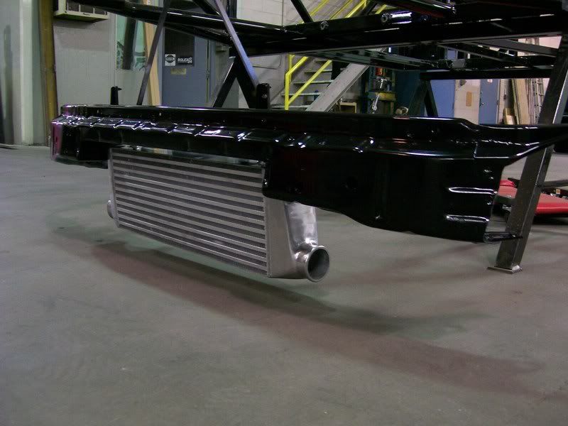

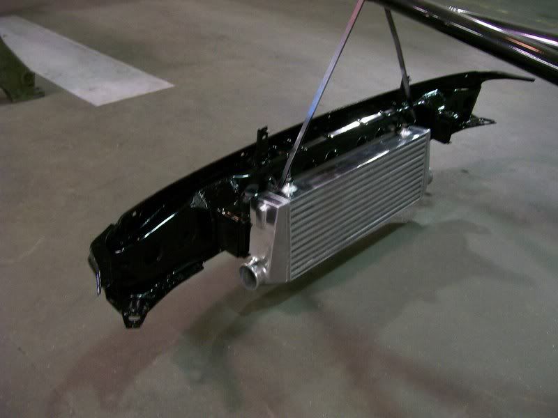

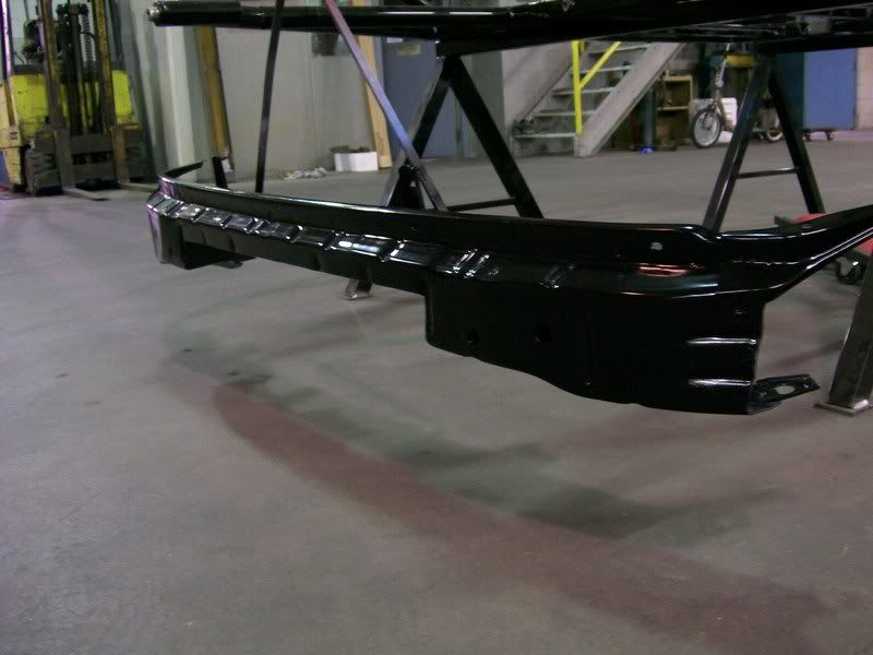

Cut out the bumper and then boxed it back in. Welded tabs to the boxed in section and bolted the IC directly to it.

Lucy had the same thing as Sethron when I got her. Cut bumper, drill and mount IC directly to it. However that made the IC hang too low so I took a piece of flat bar and made it shaped something like:
____l---------------------l____
raisning the IC a couple inches.
