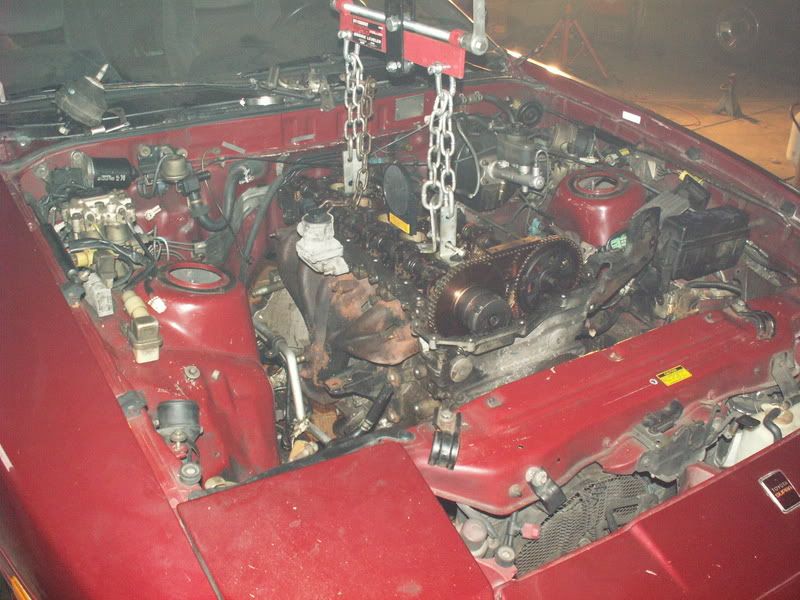

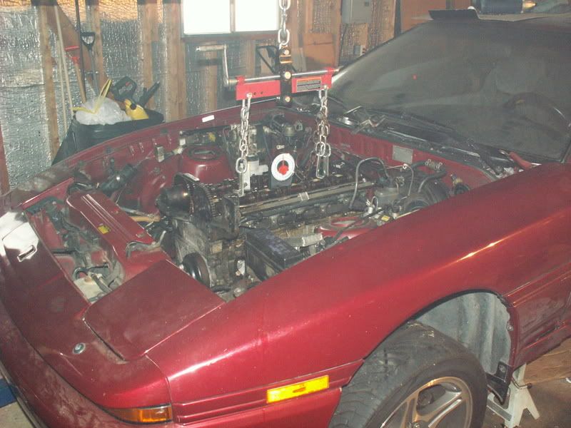

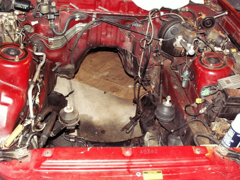

I was going to have the local welder weld me up an oil pan - by splicing an I5 pan with the I6 pan. He quoted me $700, so I decided to take a break from the pan and work on engine mounts.
Also, I picked up a core engine so that I could work on fabrication without fear of damaging the 06 motor.
Here's my first mockups using the core engine. With no pan on, I can set it right into the chassis:
The pics are hazy from all the welding I'd been doing with the doors closed.

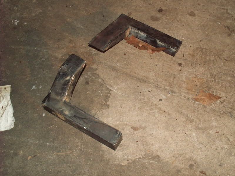

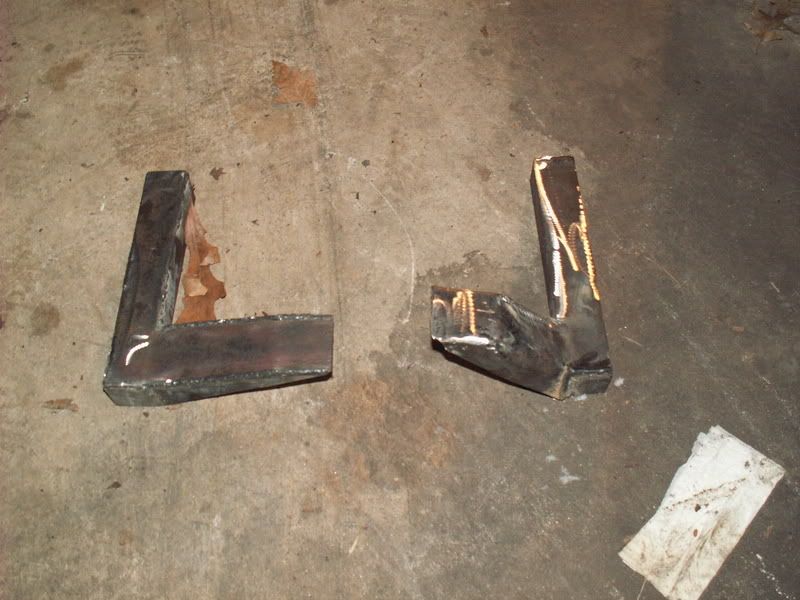

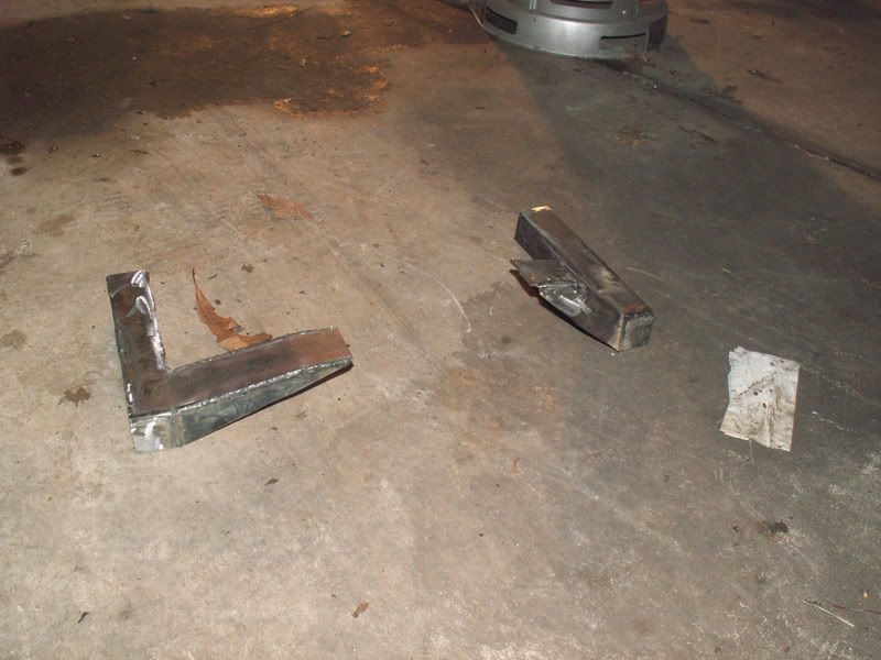

The Trailblazer engine is tall. With a stock crossmember, it would probably poke through the hood a couple inches.
So I made these:
They're combination crossmember spacers and engine mounts. This way I don't have to weld on the Supra chassis. The mounts are made from 1.5" x 1.5" solid steel stock with 1/8" sheet steel welded on to form the engine mounting points.
Here they are bolted between the frame and crossmember:

I always thought the Supra needed a body lift :)
Is the engine mounted off-center or are the mounts just off-center?
Yeah, it may take some work to get the suspension sorted after this.
For some reason, the stock engine-side mounts are asymmetrical, so the frame side mounts need to be oppositely asymmetrical for the engine to be square to the chassis. Weird.
