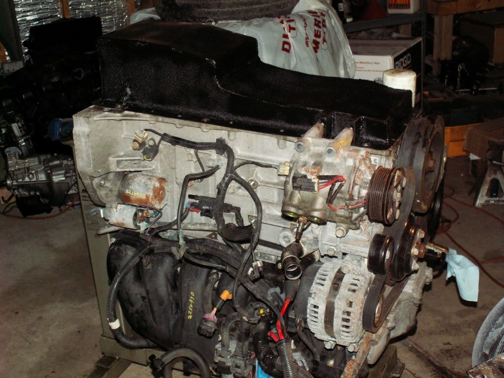

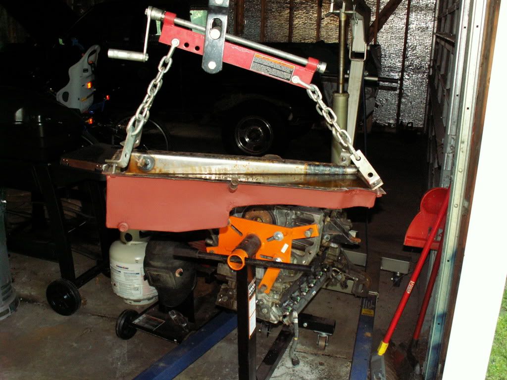

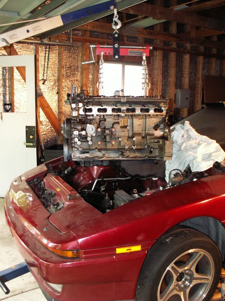

Leak testing the fab'd pan:
Making this pan was a PITA. Almost wish I had paid the $$$ to get it CNC'd
limequat
Dissident
Apr 1, 2005
532
Detroit

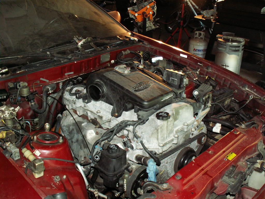

Painted the pan with wrinkle coat, installed on the spare engine and test fit it.
My 2 y/o running the cherry picker:
Tough to see anything in the pics, but it fits.

limequat;1365884 said:
I'm using a bellhousing from a Hummer H3. It bolts the 4200 to any of Aisin's AR5 or R series transmissions. Prior to this swap, I had replaced the R154 from the Supra with an AR5 from a Pontiac Solstice. So now, the entire drivetrain will be MY2006 "GM".
Is the hummer bellhousing different from the Colorado/Canyon bellhousing?
What parts of the clutch are GM and what are Toyota and what vehicles do they naturally come in? What differential are you using?

JCUOIT;1405805 said:
Keeping my eye on this build, hope to see it some day.
Not that I know of. The hummer one is just the one that I happened to find cheap.
It's going to be all GM, as I'm running a solstice transmission. It's basically a stock setup from a Colorado I5 with a custom machined flywheel. The newer hummer has a slightly larger disk, but I didn't want to pay the $$$ for it.
If you were doing this swap with an R154, you'd just sub in the biggest toyota clutch disk you could find (I think Landcruiser).
The diff is the stock 3.9 lsd.
