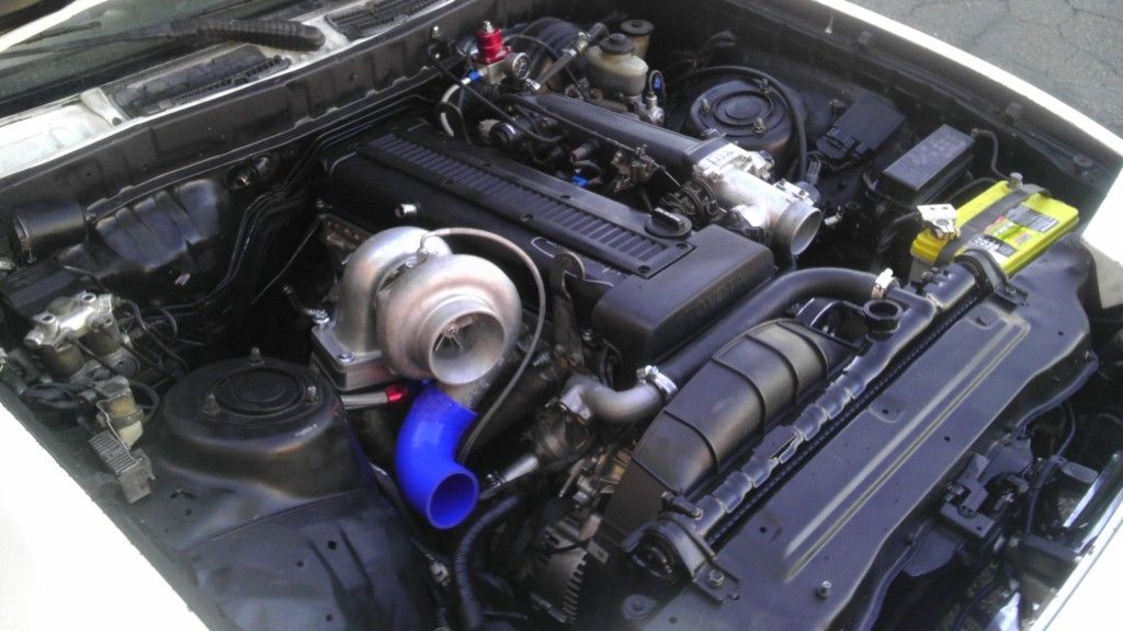

So is there any part numbers or good ways that people are doing for the hoses the go to the fire wall Intake and exhaust side?
Also i just need to run a hose from the IAC to the intake pipe on the turbo correct?

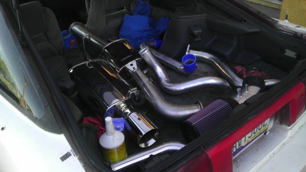

Car was on the machine shops dyno before it left last Friday and that's the only time it was on.
Its now at a friends exhaust shop getting the Intercooler piping cut/re welded so it's not a tight fit or close to the ground should be doe by tomorrow or Thursday (my birthday)by the latest.
