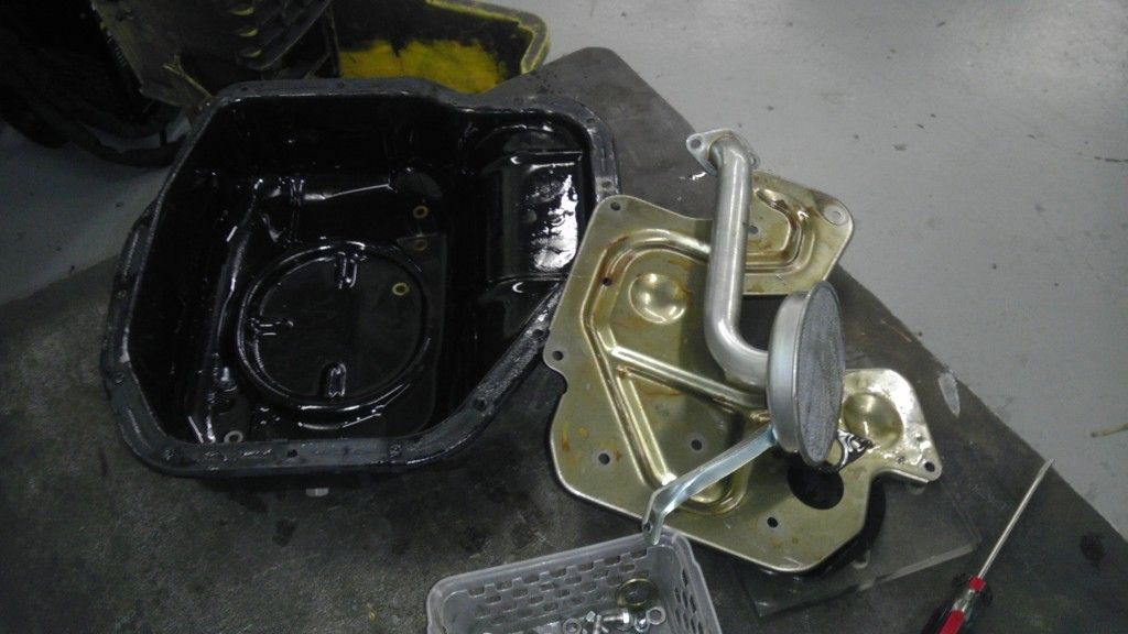

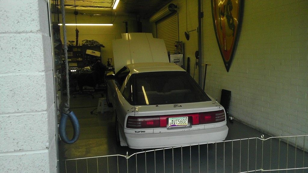

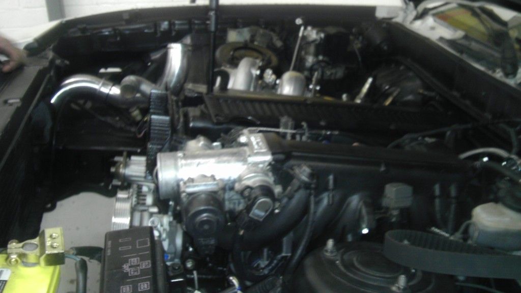

ok so went to the shop and at the moment there not sure why it has no oil pressure.
They pumped oil through the system and it still is not building pressure on it's own.
When i pulled up they had the car inside
After talking with them they think it's something simple.
He had it taken apart and ready to pull the oil pump by closing time but left it on until the morning because he didn't want to leave it off all night.

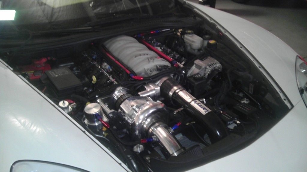

Here is another car the guy working on mine just finished up
Car made 1032 to the Crank and 820 whp on there dyno's

Not 100% sure but he said he thinks its along the lines of a Folded o ring or pin or plug problem said somethings simple that he would know when he pulls off the pump in the morning.
He said that he doesn't think it's the oil pump it self
