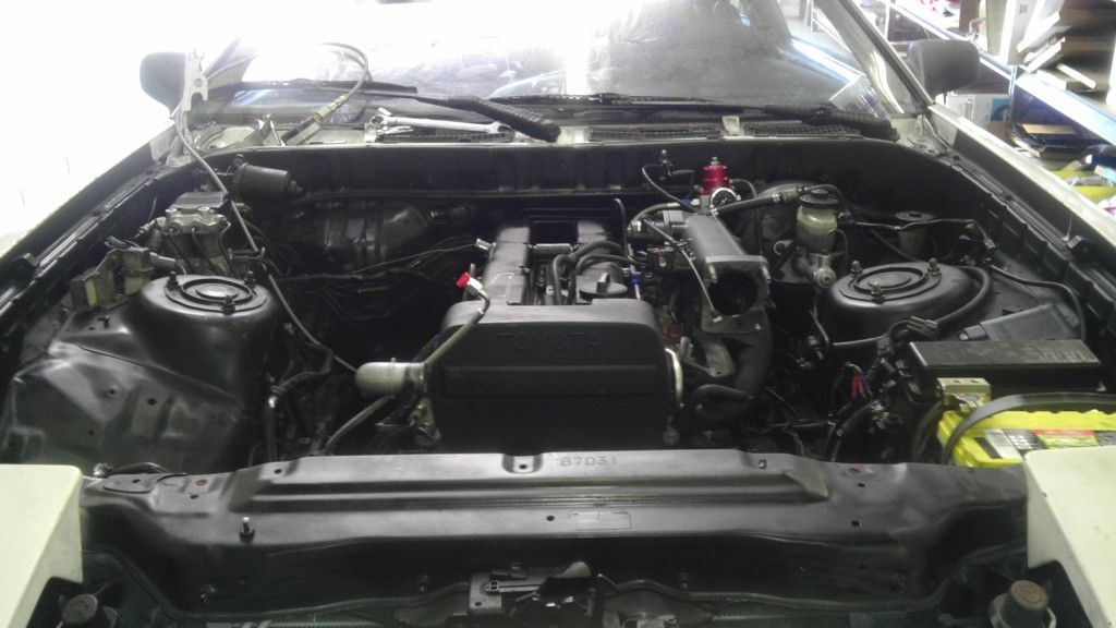

So update went and hung out with the guys at the machine shop today and came back with a video and a bunch of pics
[video=youtube;Y_8Q-BRobBs]http://www.youtube.com/watch?v=Y_8Q-BRobBs[/video]
So here's some pics of the car and how its sits now
And the motor
Random Pics of the shop
Some more parts that came in today... Aaron said my AEM V2 should be here next week and the BC cams by the end of NOV.
