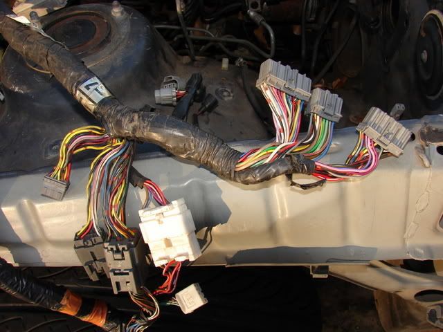

I'm now at the stage of needing help. I have a picture here of how my wiring harness was in the grey car. All wiring from the dash has been removed, but the motor and harness are still in the car. The picture shows it all out in the open, like it was plugged in the car.
The question I have is about the big white plug. It is plugged in on the 90 turbo car WITH Air Bag, but there is no connection for it in the 89Turbo WITHOUT Air Bag. I am assuming that the plug is for the air bag, but I do not know. Can I use the current harness in the 89, and just leave the white plug unplugged? The answer to this question has a lot to do with how soon the 89 is running. The only other thing I need is a motor mount, and to swap out my oil pan.
The oil pan is scarry looking. It has a large dent in it. Maybe the crash was a good thing, because it just may have saved a very good running motor.
Here's the pic. The other two loose plugs are not of concern. The little white plug was not used before, and the little grey plug hooks into the dash. The other 3 grey plugs go to the ECU.
