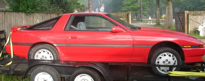

Ryan....I truly have always hated a red car! But you have to jump on a deal when it comes along, and my last couple of deals to come down the pipe have been with these RED cars. Nothing is official so far on that car, but I really doubt that that car is going home. I can drag my feet on the motor install until I have the cash to pay for the car.

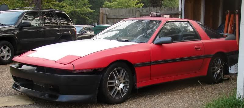

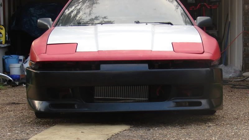

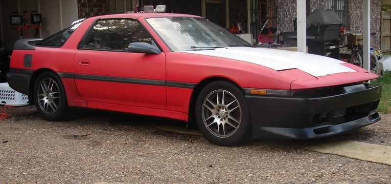

I have been wanting to see this in person as bad as you have been wanting to see pictures. I'm close enouh to being through under there that I went ahead and put it on the ground to take these pics. The header panel and bumper are both just sitting on the car unbolted. One small tap, and it all falls off. The driver side just won't quite stay up where it is supposed to be. I'm really liking how it sits with a motor in it and the bumper on it. This is the first time I have seen this too. Now, I can't wait to see it with my Bomex installed and after it has been painted all one color.

AIM FTW! *does the i-get-to-see-cool-new-pics-first-dance!!!!!* and i must say....I WANT! :love: :love: :drool:
EDIT: dang it, you already posted em, now i can brag as much! :biglaugh:

Looks awesome! Also it looks like you may need to go with another set of wheels to really set off that super red and Greddy front bumper combo! :) I cannot wait to see how she turns out all painted and pretty!
