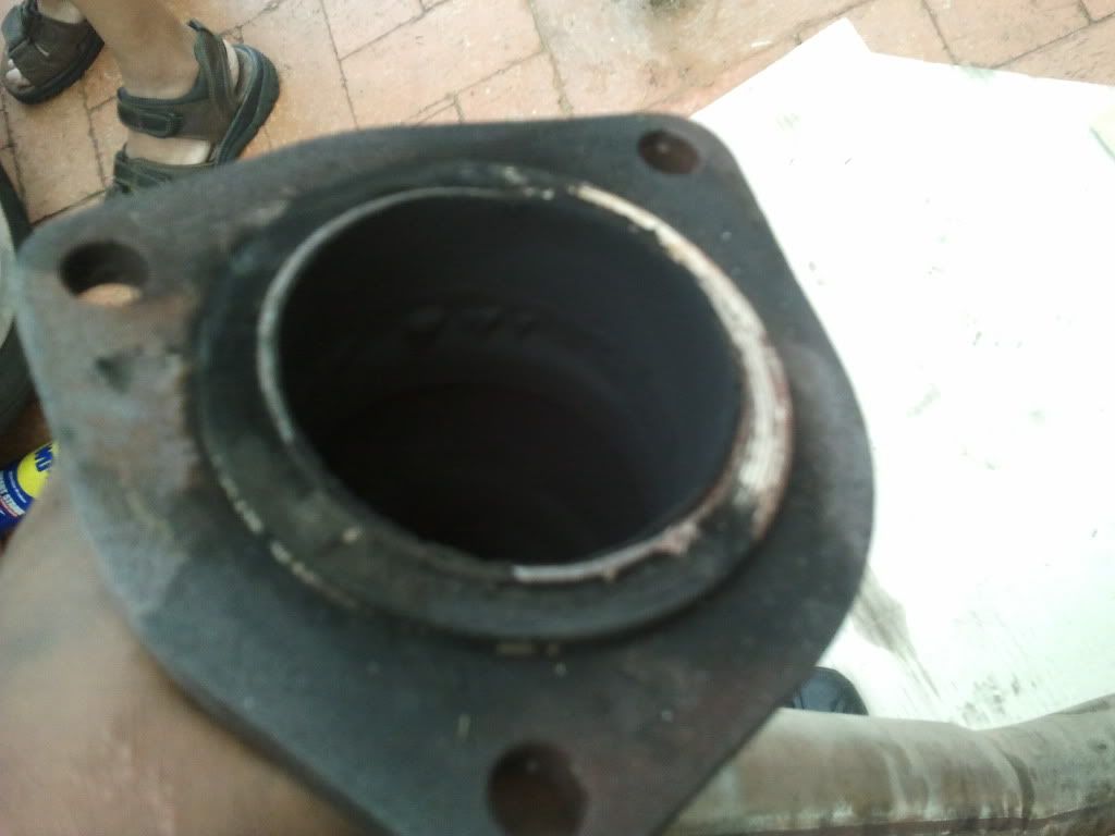

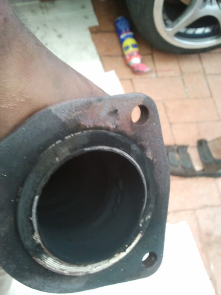

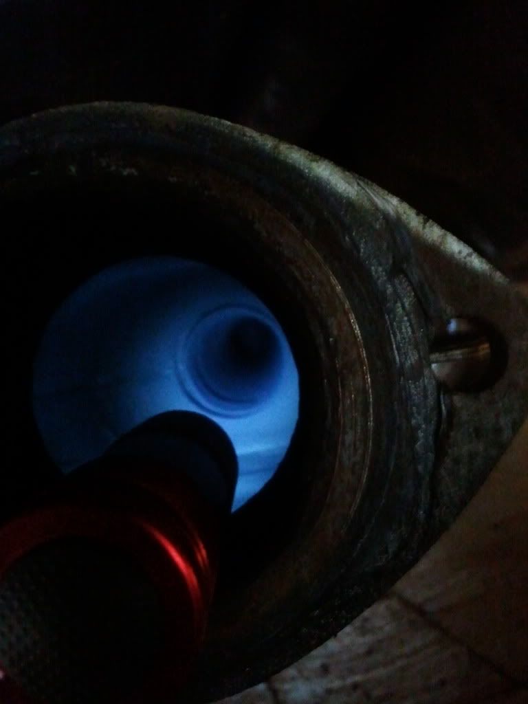

so removed the dump pipe today. didnt seem to be any visible oil :
Towards cat and muffler - no blockage
Just the usual amount of smoke appearing after the dump pipe was removed. Didn't seem to be extremely white or excessive , just normal exhaust fumes. How can this be?

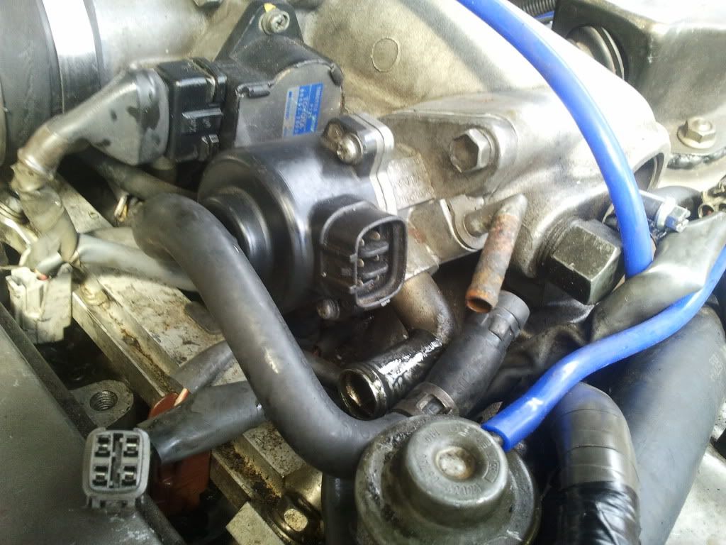

Also it was suggested that there might be oil in the lines running to and form the iscv as the white smoke happened mostly during idle. Disconnected the lines , their seemed to be a little oil as you can see:
After all this , the smoke still exists , only when warm and only during idle.
Dont know what else to do...
