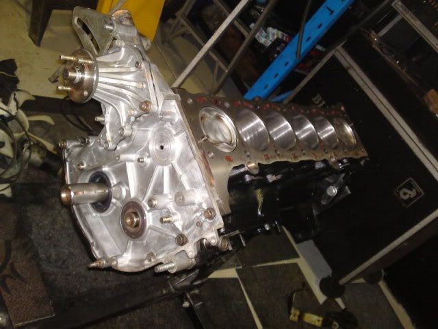

ive been told this by a few people.its far too black after only a thousand k's. Im pretty sure he cleaned everything before he assembled, I had pics of it and everything, then again after the last year I trust almost no one now.
